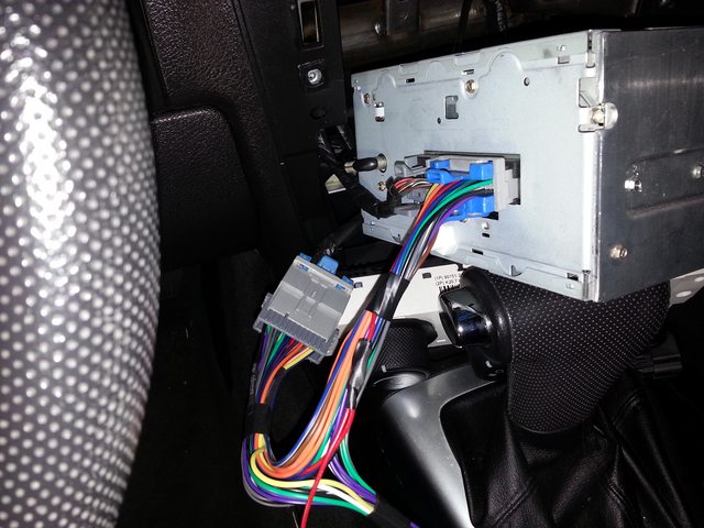

Next, remove the four screws the holding the radio and be prepared to catch it! Disconnect the big plug at the back and connect one end of the GM-2MKi wiring harness to the radio and the other end to the H3's factory harness. The single red wire will need to be connected to a switched 12V circuit. The third connection (black ISO) goes to the parrot module.

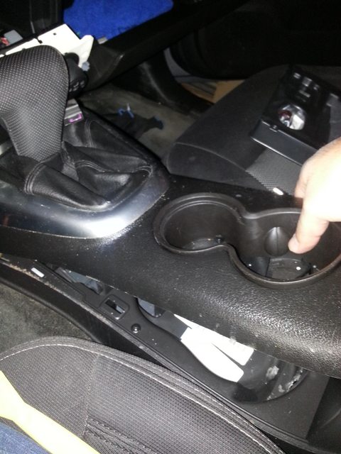

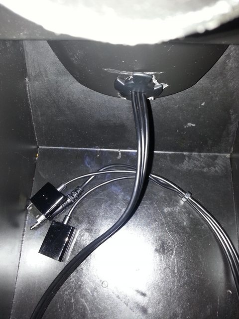

I routed my aux cables to the inside of my armrest but you can put these anywhere. Some people just leave them in their glove box. Get a firm grip on the cup holder and pull up with all your might and it will pop out.
Attachment 27624
Next, make a hole in the inside of the armrest and route your aux cables. I believe I'm missing a storage container that goes in there :confused:.

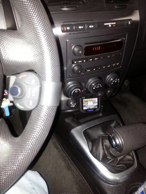

Next, I installed my steering wheel control and LCD display. Again, you can install these where ever your heart desires!
Attachment 27629
With the shifter in Park the LCD display gets blocked but I don't care. I find myself hardly ever looking at it. When you get a call it verbally says the name or spells out the number that way you never let your eyes off the road.
