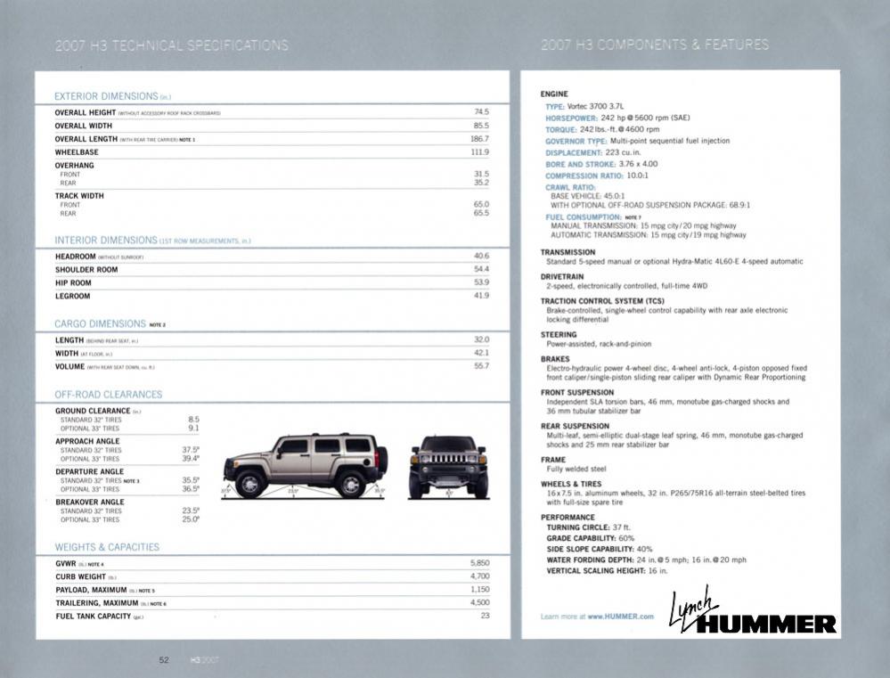

2007 was a transition year. Late 2007s had the power windows in the same location as the 2008, at the front of the armrest. Early 2007 had them at the rear and it is kind of awkward to reach. 2006/2007 had slight differences in the air intake from later years, so the parts will not interchange. As mentioned, the front bumper is black on the 07 and silver on the 08. The 08 had head-curtain airbags that the 07 did not have. The 07 is about 150 pounds lighter than the 08 in stock form.
Attached is the spec sheet for 07 that shows stock heights and stuff.
