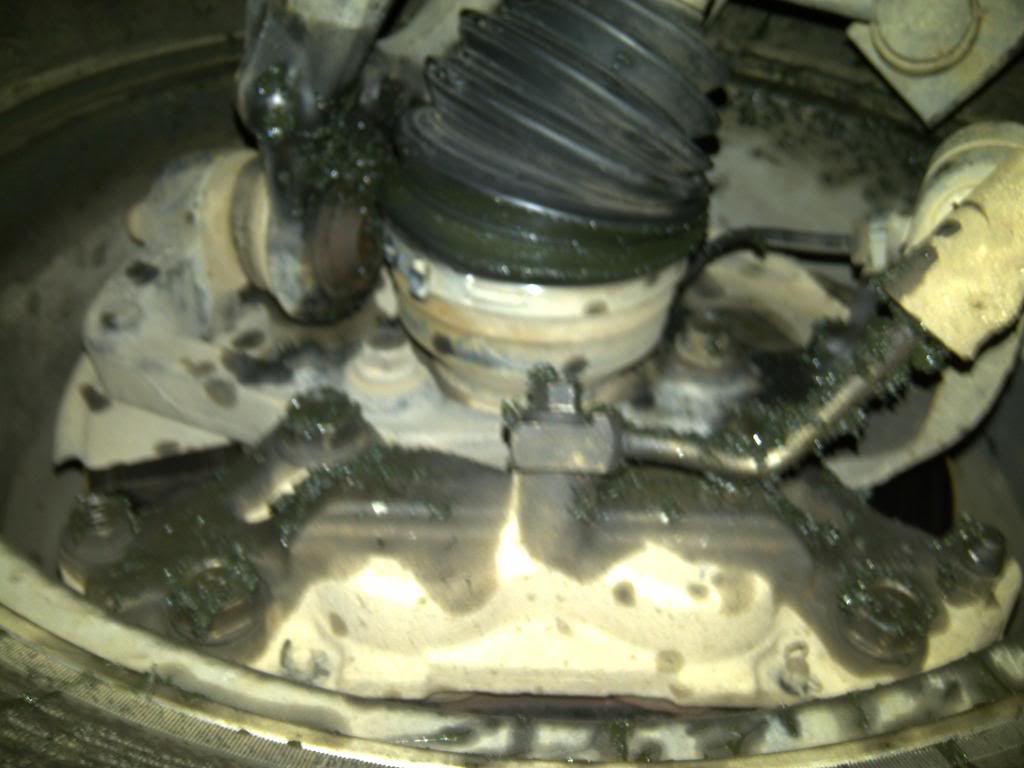

So as assumed when lifting the front by cranking the torsion bars, the cv axle boots have wore prematurely. This is do to the higher angle and stress on the boot. Since a lot of us have lifted our fronts, is anyone else having the same problem? I am planning to order RCV Performance high angle boots, which they claim to be perfect for high angle applications since they're "made differently".
Does anyone have any experience with replacing the boots on our trucks and/or with rcv performance?
I'm not looking to go down to the auto parts store and buy a re-manufactured axle. My axles only have 80K on them and the boot is only leaking between two of the bellows and not tore (yet).
Does anyone have any steps on removing the cv joint aka half shafts from our trucks?
Attached is a pic of the problem boot and its angle.

IF, if.... the failure was because of a T Bar adjustment to level the front, you may have went too far. I've seen and heard of many people who lifted past 23.5" from fender to hub center have half shaft failure.
If you did not lift too far, you got 80K miles out them on a truck you have been wheeling, that ain't bad. Boots break down, and in my experience, when you need a new boot, CV joint failure is not too far behind? I witnessed an 07 that I did the T Bar lift on at 23.5" with around 20K just blow out (and I mean flying fragments) the driver side half shaft.
Personally, I'd get ahold of theBroken @ Ridgedemon and move to 08 - 10 halfshafts, reboot yours for trail spares.
Go over to Hummer X and search, CB Photo did a picture how to on the half shaft replacement, that I think was also copied to CHO.
Best of luck.
Best of luck.
