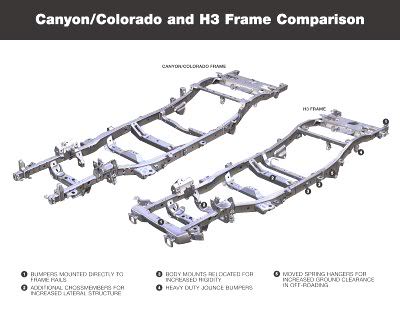

will a 4" skyjacker lift for a 05 colorado work on my 06 h3? my buddy has one brand new in box hes getting rid of for a couple hundred and i know the two are pretty much the same. if anyone here knows let me know asap
Who told you that? I don't know where you got your info but it is incorrect. Here are the BIG differences in just the frame. It won't work. If it did work they would have marketed it as such.
http://gm.wieck.com/forms/gm/previewpage?023628
TAINTER....can you tell me where to get a better copy of this?
I can't read the bullets listing the differences, and it appears some are missing, so I don't know if there's a second page. thx

Click the link in his post and then click the link that says "download". There are no missing bullet points, just multiple locations for some of them.

I have both rigs... 4 inch skyjacker on the colorado. Even though these two the hummer and colorado/canyon are the same platform they are different. The lift is not interchangeable. The cross members are way different and so are the hub carriers. Rear add a leaf should be the same but nothing up front is. Hope that helps...
