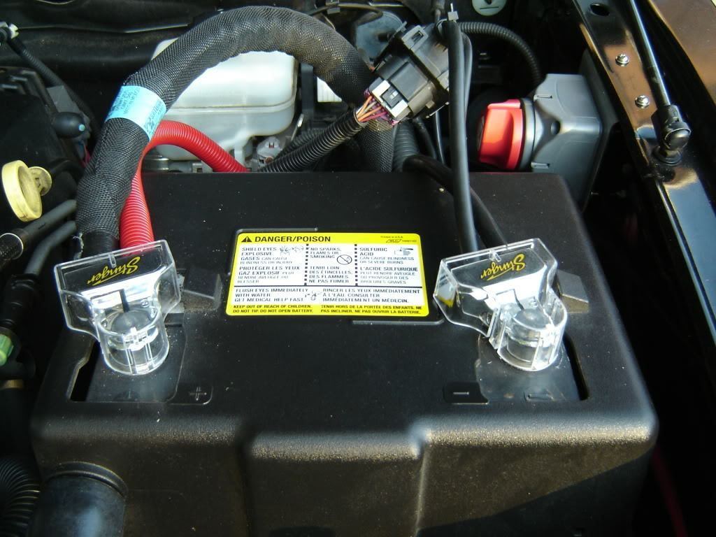

Start with battery replacement and NEW QUALITY TERMINALS.
650Hawk explains it here:
Originally Posted by 650Hawk
The stock POS battery terminals are the first thing EVERY H3 owner should replace; NOW, not later. Use stingers, or any other good, solid brand. Those OEM terminals are the cause of many, many H3 seemingly unrelated gremlins since the H3 is extremely sensitive to voltage variations. It's not a matter of :"if" they will fail, it's a matter of "when"...even if they "look" good.
Doc Olds also posted many times the need to change the terminals!
I installed the stingers (SPT55301) 7yrs ago and never a problem:
