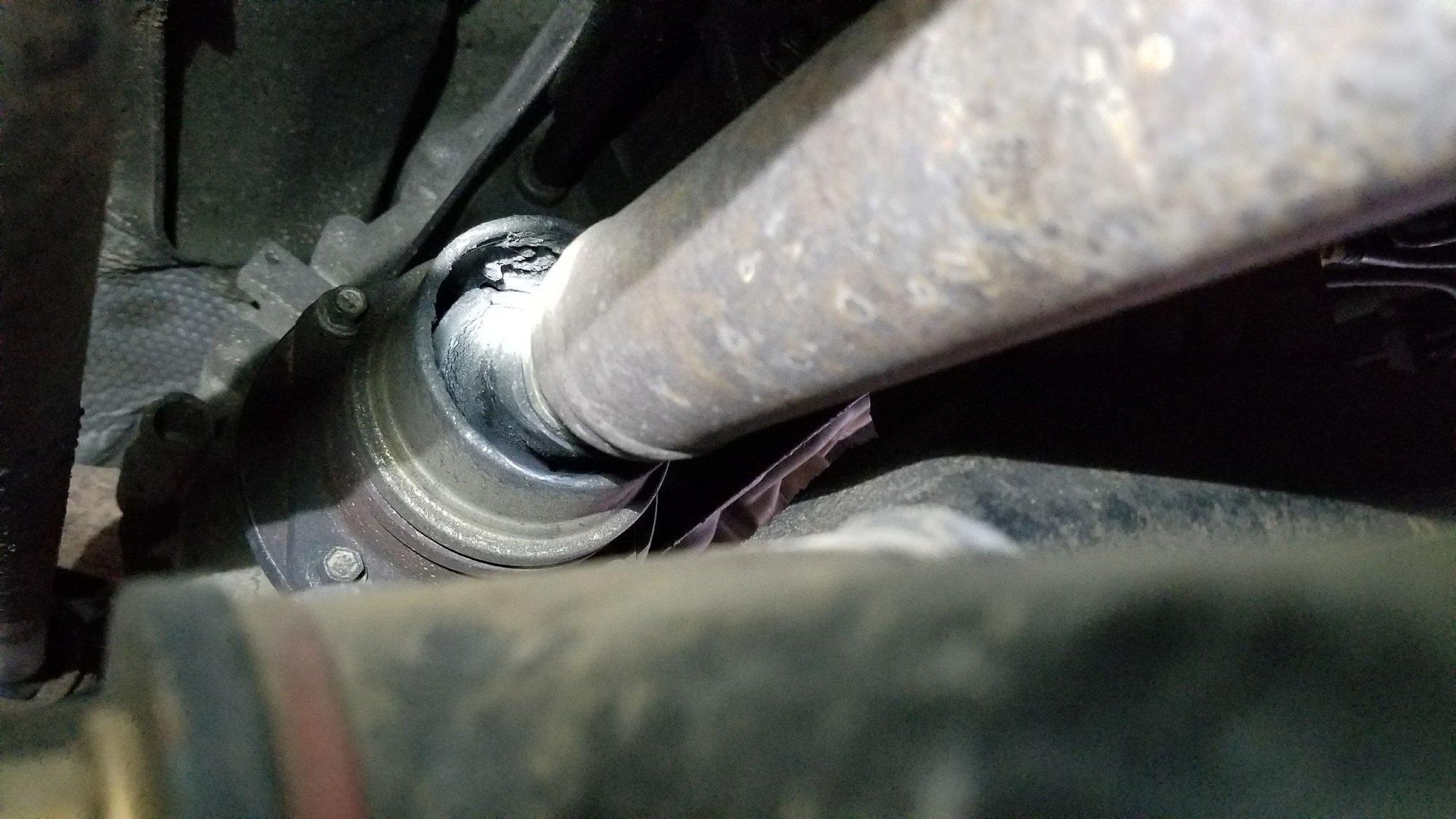

I'm thinking this is the source of the noise.... this is the front drive shaft coming out of the transfer case...I don't know what its suppose to look like. but I put my hand on this and kinda rocked it back and fourth and it sounds like my suspected noise...

Prop shaft cv joint. Pull 4 bolts and see if it is shot. Easy to replace.

yeah I just watched a vid on he shaft replacement... I'm going to go pro the sound maybe tomorrow and post it...
