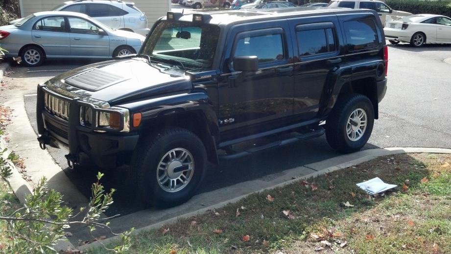

Just got my 06 H3 about 2 weeks ago and today was the first chance I had to tear into it. It's got the Luxury/adventure pkg with 97k miles. I think I did pretty good on my first Hummer purchase! It's idled a little rough since I got it, so today I did some basic maintenance.
Changed the plugs- NGK IX Iridium (4344)
Cleaned the MAF
Cleaned the Throttle body
Air filter was new so it didn't get changed and the oil was recently changed and looks pretty clean. That took about 75% of the rough idle away but I found a coil pack that had a bunch of corrosion on it. I don't have any codes or a CEL but maybe that pack is running half assed??
I've seen where some people clean the screens on the VVT solenoid valve but I'm not sure exactly where it is. Could someone point me in the right direction?
