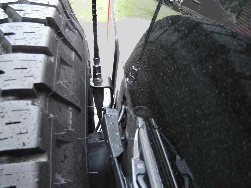

I have a glass mount antenna for my police scanner in my 3 attached to the back window. I have seen most antennas attached to the back via the rear spare tire setup like your second pic.

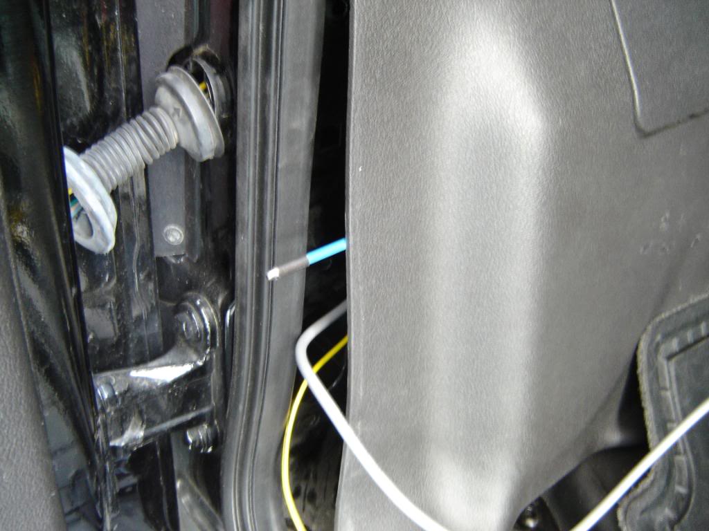

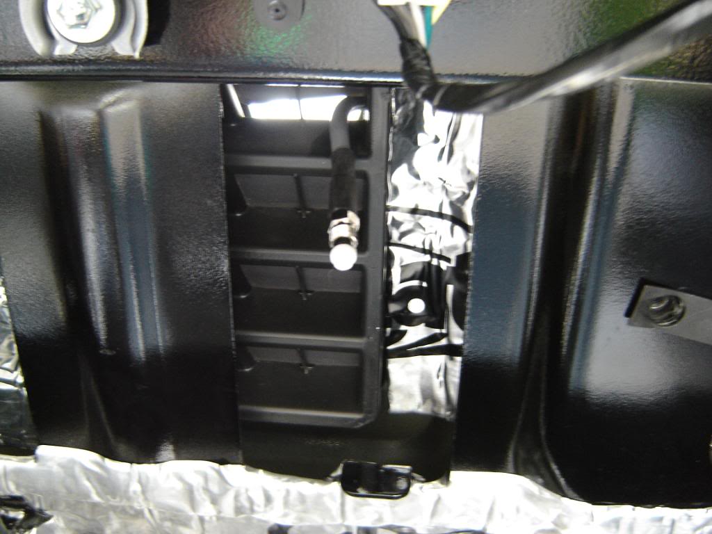

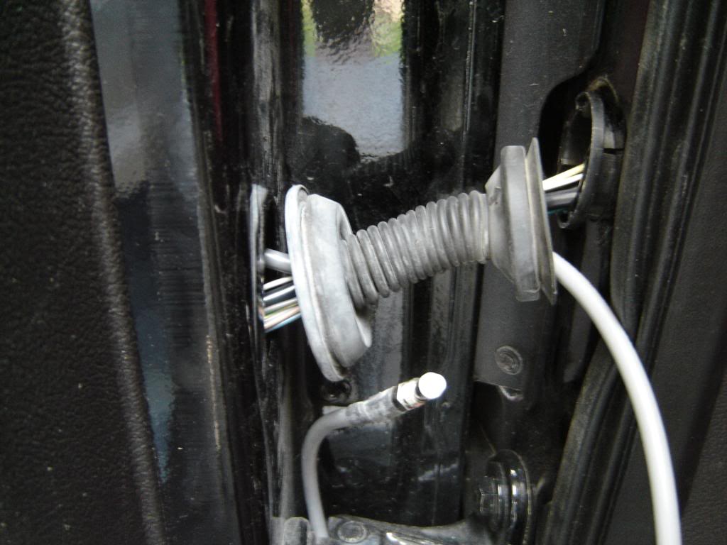

You should find somebody with an SWR meter to tune the antenna once you mount it. You may or may not need a ground depending on what kind of antenna you choose.
I ran a groung from the mount bracket to the chasis by screwing and terminal eye butt connector to the cab under the back door sill plate. I have a 4' K40 SuperFlex whip that is top loaded for an easy SWR tune. It reads under 1.3 as mounted in the above pics.
Antennas are tuned either at the top or bottom, either way, basically you have a set screw and you move the metal wire part of the antenna up or down a smidge to adjust the SWR as close to 1.0 as possible. Some fiberglass type sticks have a cap at the top, which you remove and clip off a small piece of the coiled wire of the antenna under the cap to tune it. Cheap antennas may not even be tuneable, you just slap them on and cross your fingers that they work well enough not to damage your transmitter.
The small antennas, and some of the magnetic bases that can attach to a hand held, don't get out very far, but they work well enough if you are with a group and using them short range. Hand held CBs are weak, they sometimes barely get by, other times they are basically worthless, depends upon brand, what antenns you are using etc.
There arfe some good on-line resources out there, read topics on antenna selection, mounts, and SWR tuning.
