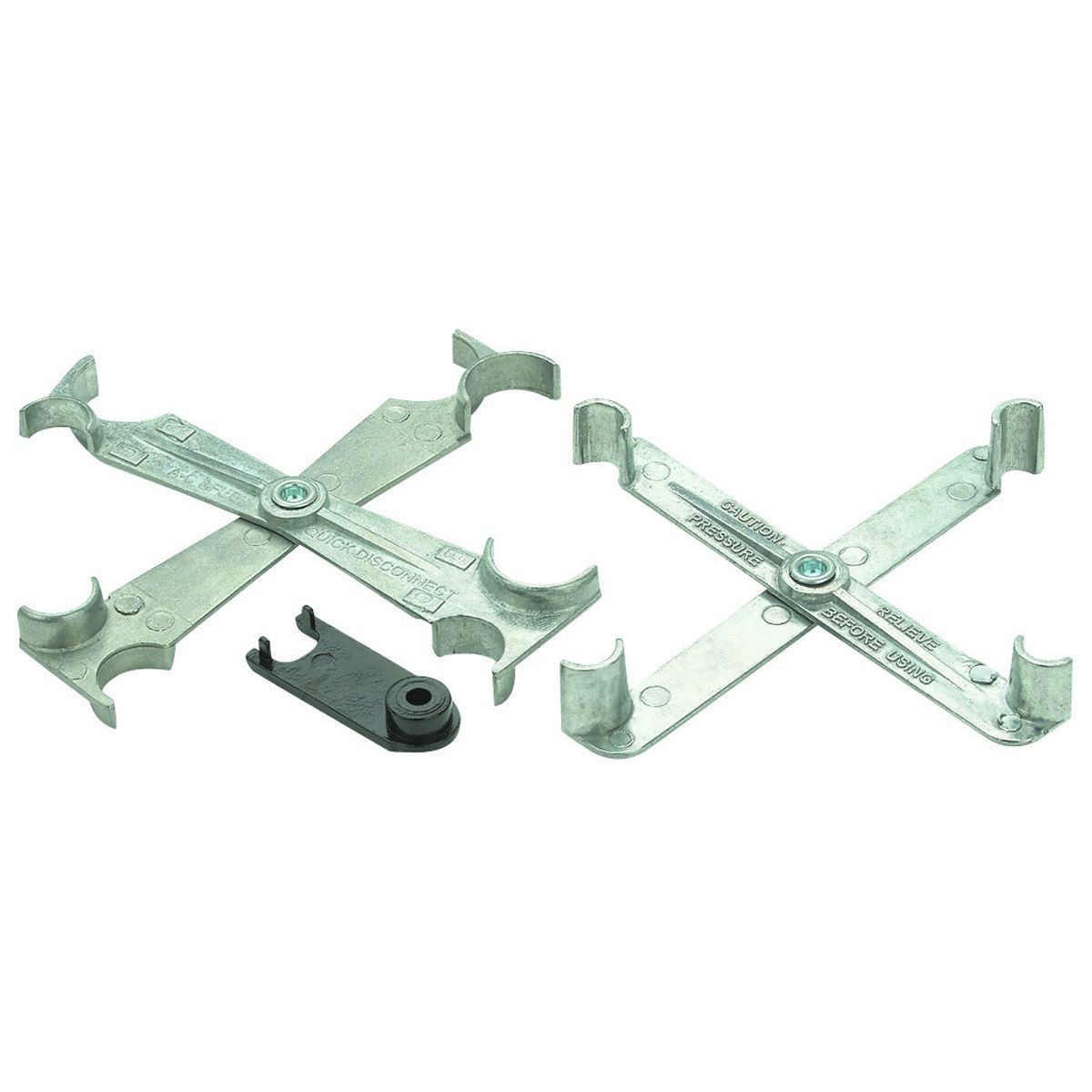

07 H3 rotted fuel line.
never seen a fitting like this,,i tried my disconnecrt tools ( white in pic) proper size,push in on fitting then push in on tool and try to pull both back and nothing..

spray some lube. the o-rings might be stuck. you did remove the big silver clip right?

Silver clip is a retainer, remove it then push the fuel lines towards each other before pushing the tool in to release the locks.
may need a metal release tool

Both of you are correct !
i needed to lube and i needed the metal tool instead of the plastic i have.
great,two answers and both good info,,tnx guys.. :
