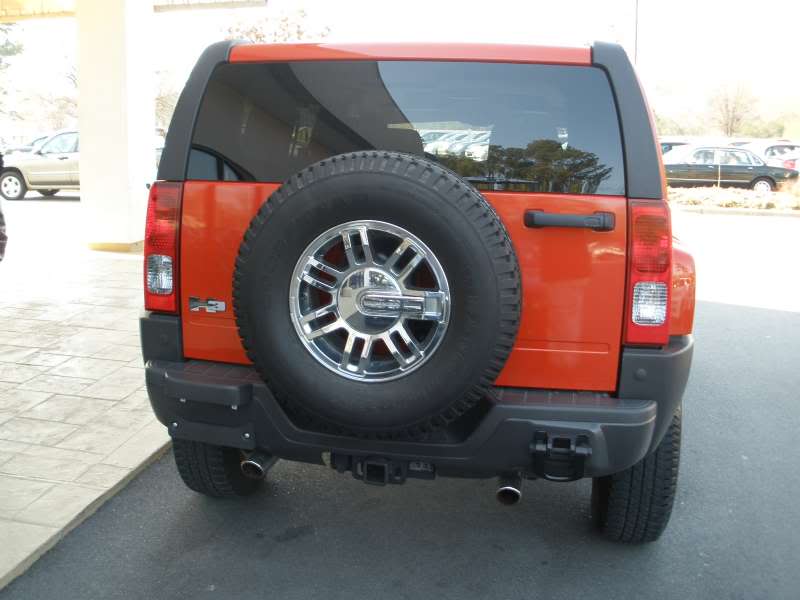

*Update*
I bought an H3 last week, FINALLY!
It's a 2008 with a 5 speed(which I love), just over 21,000 miles, Solar Flare Metallic, aftermarket exhaust(haven't figured out what it is yet)...
...and got it for $21,900 which I thought was a good price
Already been off roading twice. I have two jobs, which is how I'm paying for it, and any spare time I have now is spent on some dirt and mud. I absolutely love my H3! I can't wait to go to the off road park in Hot Springs, AR(close to where I live). Anyone else been/go there?
