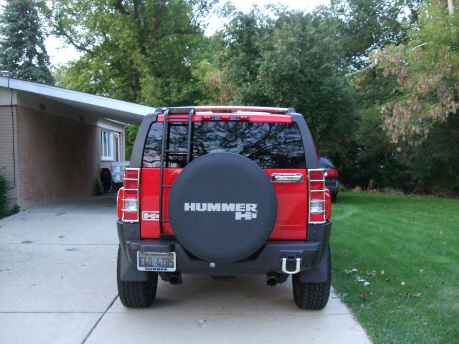

i have the gobi ladder on my 06 h3 but i went with the soft tire cover with reflective logo also i have heard some have a issue with it cause there spare tire is to big i run 275/60/r20 as for the head unit thing i never heard of something being to new to replace in fact maybe pulling exactly when u get home and did not use it maybe can fetch alittle more money in resale but there are people that will say once u drove it off the lot its not new its now used.but good luck and if u swap head units and u have onstar u will need a harness to retain factory door chimes and on star.think they sell for $200 but shop arround also u will need a new antenna adapter for the new head unit.can get pricey but most agree worth it for all the axtra features u get out of a after market unit

thx so much dude! the headunit/adapter part is exactly what i heard from geek squad last night and it's just so good to get confirmation here. i already ordered everything except tire cover. i'll see what i can do after installing the ladder. appreciate it!!
