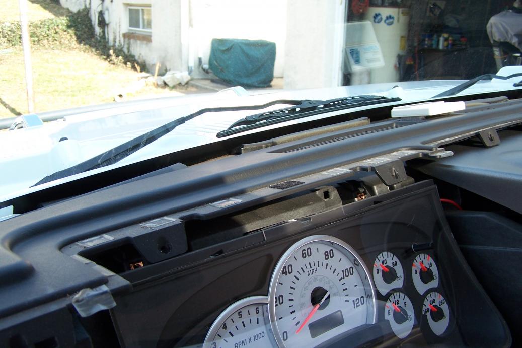

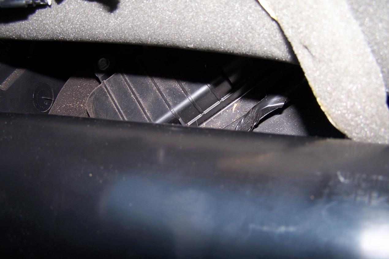

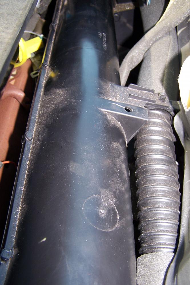

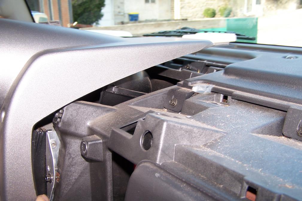

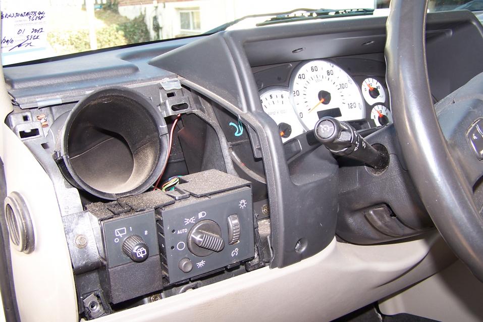

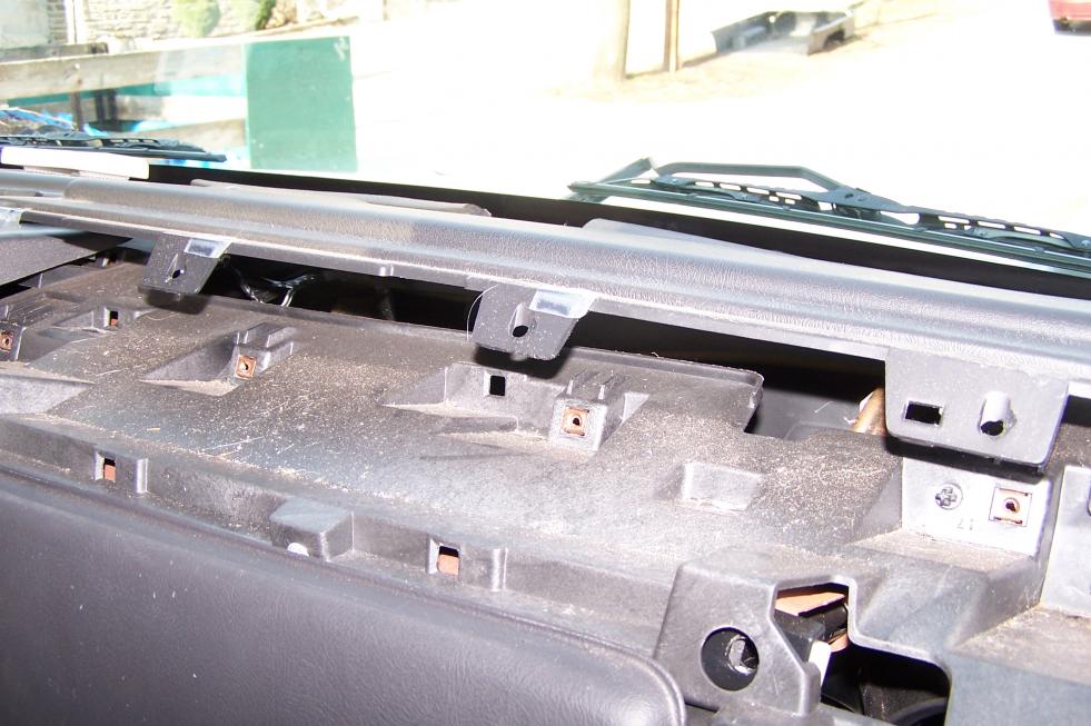

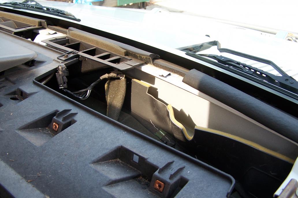

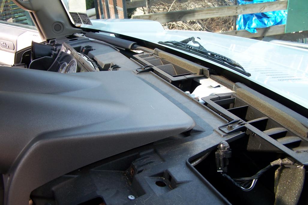

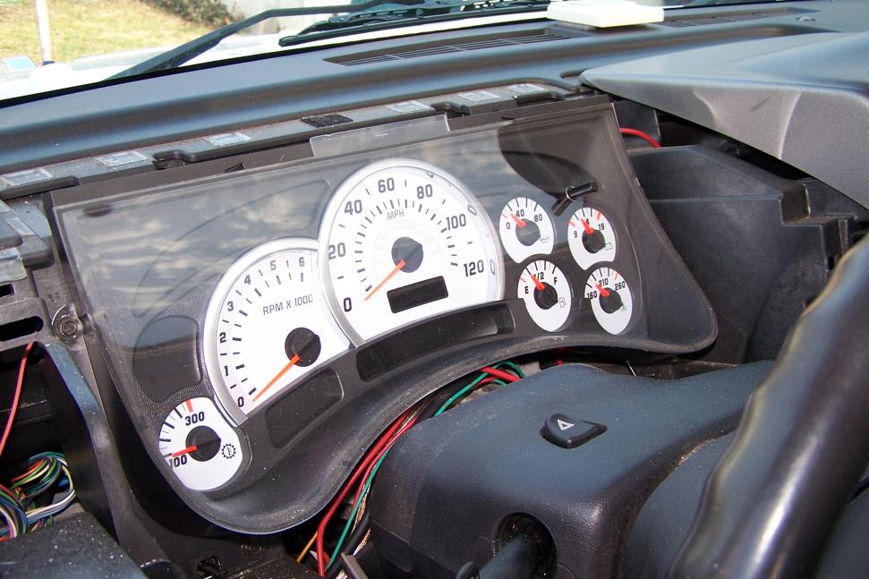

Default Pictures of dashboard removed
Here are some pictures of my dash apart
Attached Thumbnails Blend Door Actuator Replacement-000_1509.jpg   Blend Door Actuator Replacement-000_1510.jpg   Blend Door Actuator Replacement-000_1511.jpg   Blend Door Actuator Replacement-000_1512.jpg   Blend Door Actuator Replacement-000_1513.jpg
Old Nov 27, 2012 | 10:53 AM
  #83
ingydrummer's Avatar
Joined: Jul 2011
Posts: 135
From: King of Prussia, Pa.

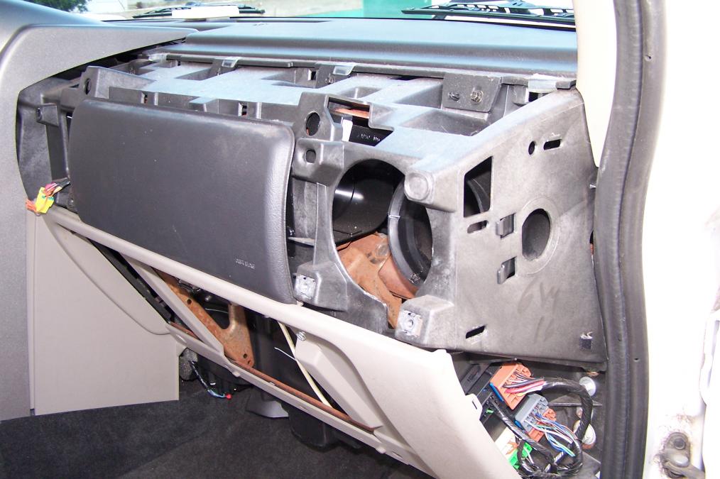

Some more pics
Attached Thumbnails Blend Door Actuator Replacement-000_1514.jpg   Blend Door Actuator Replacement-000_1515.jpg   Blend Door Actuator Replacement-000_1516.jpg   Blend Door Actuator Replacement-000_1520.jpg   Blend Door Actuator Replacement-000_1521.jpg
