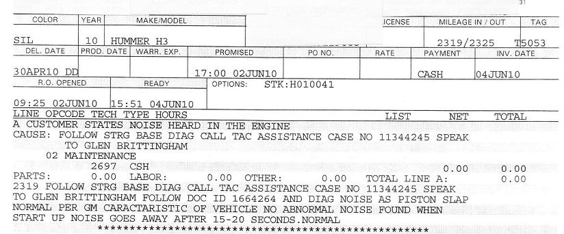

Please give me your opinion and some advice,
This is my 2010 Hummer H3 Alpha with a case of "piston slap" according to GM (I just got it back from the dealer). It has 2500 miles on it and has been slapping since the 1000 mile mark, getting worse over time. The sound does not go away in 15-20 seconds after start up and is very loud as heard in the following 90 second video.
http://www.youtube.com/watch?v=ZlDDd1H1CXU
Here is a copy of the service report.
Attached Thumbnails BAD Piston Slap? 2010 Hummer H3 Alpha-h3-service.jpg   BAD Piston Slap? 2010 Hummer H3 Alpha-h3-sig.jpg

Sounds a lot like mine though not quite as pronounced. I had the Hummer dealer and 2 Chevrolet dealers tell me that it was not out of the ordinary for that engine. My I5 was much quieter. As long as it is not going to fly apart I am not too concerned about. It's more embarassing than anything else. I hope somone else on the forum that has had experience with the 5.3 will chime in.

I took it to a different Chevrolet dealer and it got transferred back to my original dealer per GM's orders.
Dealer replaced the rod bearings last week and re-assembled, still knocks. They said the piston bores, main bearings, etc all looked perfect and they have no idea why it is knocking, just really bad piston slap is the best guess.
My dealer is handling it very well and doing everything they can to make sure I am taken care of.
They are putting a new engine in it now.
