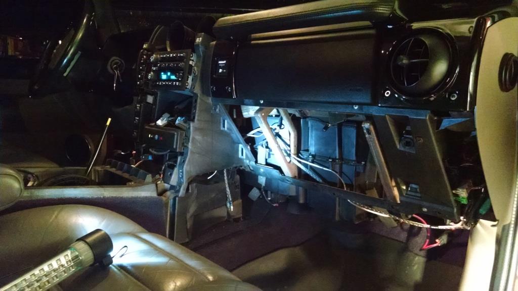

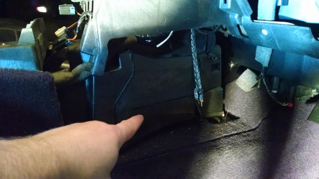

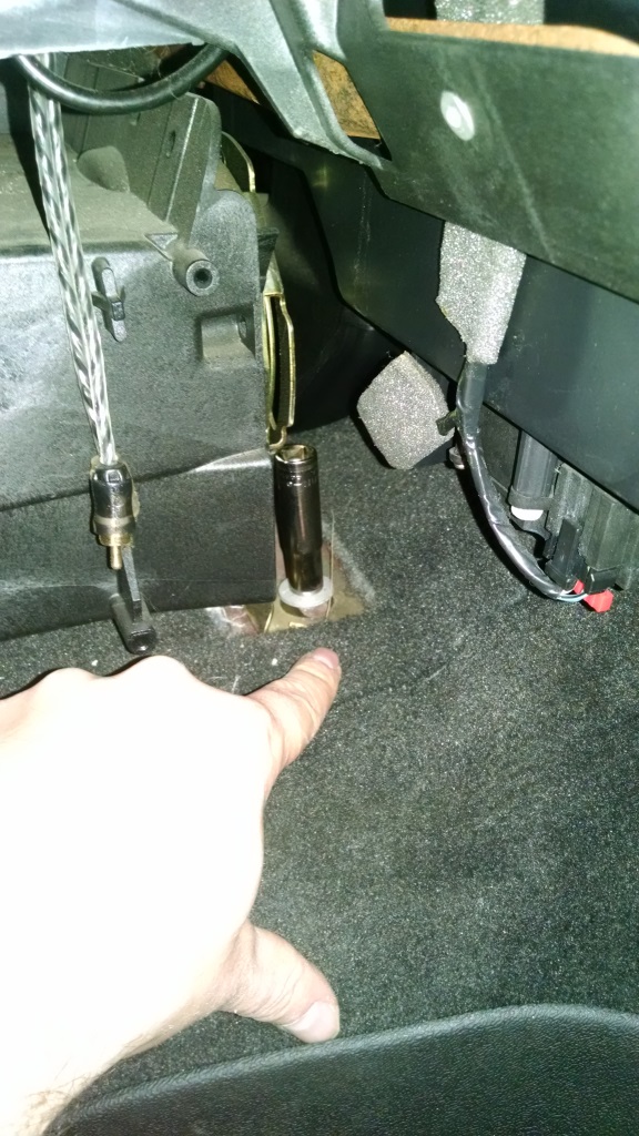

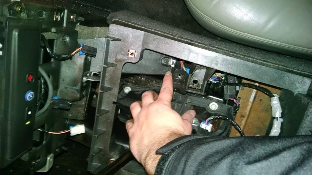

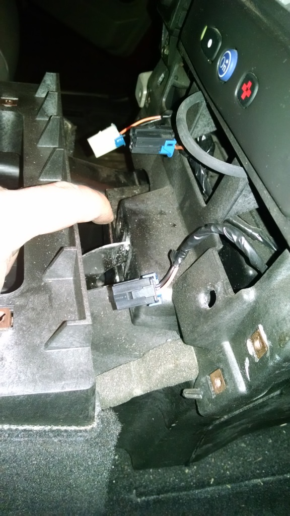

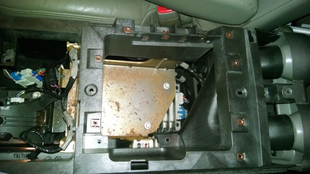

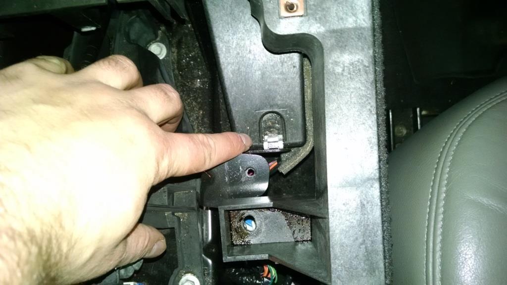

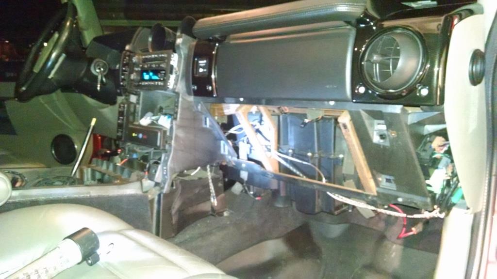

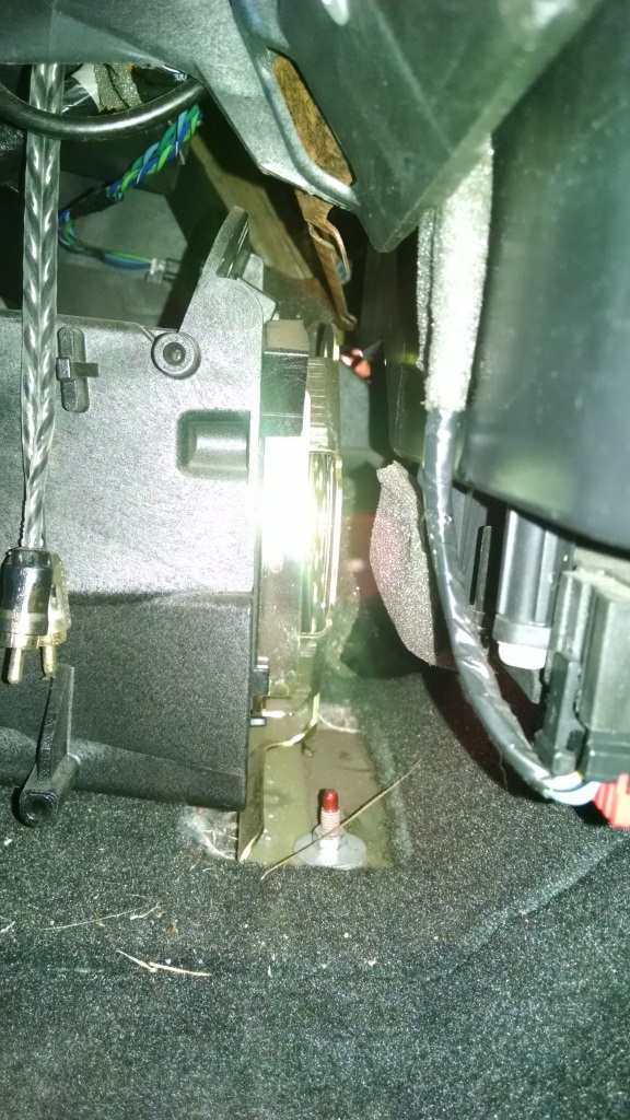

pics are below i hope, the silver part is the amp
i am pointing to the sub, also pointing to the screws and nut in the photos that need to come out to get it loose. I havent got it unplugged yet, it will most likely be next week before i get to it, as i will be out of town this weekend.

as you can see, the previous owner wired it for a different amp already, but never got around to it before he sold it. I left the wires in there just in case but i dont think i will ever mess with it. it was easier to leave the wiring in there than pull it all back out again.

havent got mine completely out yet, how did you get it past the bottom portion of the enter console? pulled it to the passenger side?
steve
Old Oct 30, 2015 | 03:45 PM
mulepic's Avatar
Joined: Aug 2015
Posts: 275
steve
Yep, it comes out the passenger side. You need to take out that last piece of carpeting along side the passenger side seat between the console. Then it'll come out.

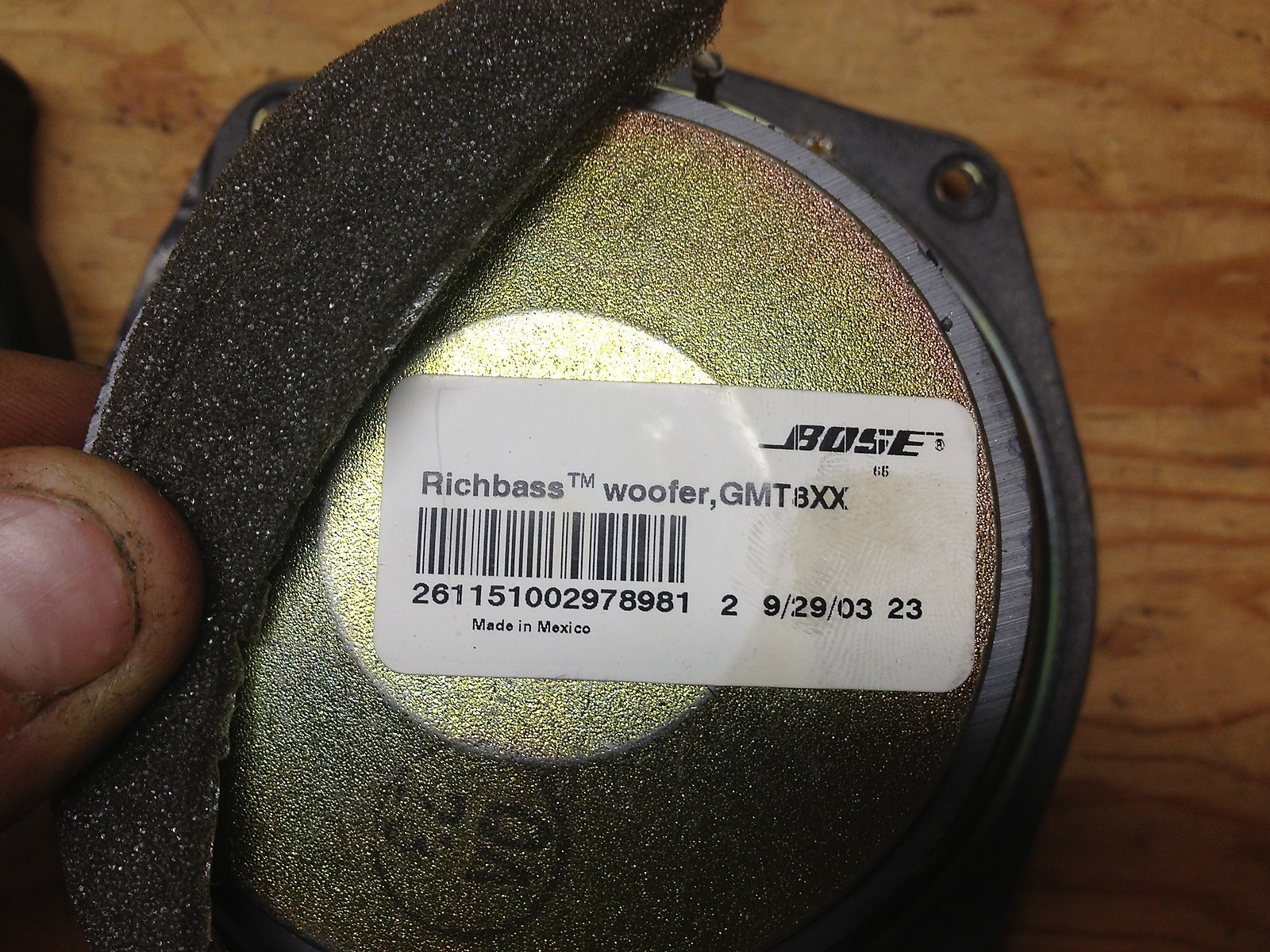

I took the subwoofer out of the enclosure. It is a dual voice coil 6" woofer. It's pretty decent. On the sticker it says "Bose richbass woofer" which you can find for $35. So if you are thinking about replacing yours b/c you think it's blown, save yourself some cash and just replace the woofer.
I hooked up 5v DC to each of my voice coils and they both work. So I guess my subwoofer is fine. It's just my expectations are too high I guess. Now I wonder if there is a subwoofer gain on the amp....hmmm.

It looks like the sub was the ticket. It is bumping well again! I had everything removed that was needed in the photos above, it just pulls out to the passenger side as you lift the center console part up. One connector on the driver side top of the sub and it is good to go.

late to the party, but here is a picture of the sub for future reference
