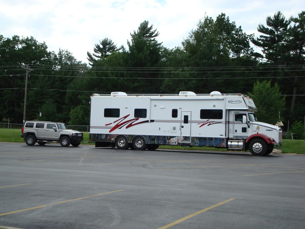

I have no idea who this guy is, but he showed up at Silver Lake Sand Dunes with this set up, and left that way too.
I've seen others doing the tow behind set up. Read the Owner's Manual, it covers towing with all 4 wheels on the road.

WOW!!! that's one heck of a setup! I will look in manual....thanks for the pic
