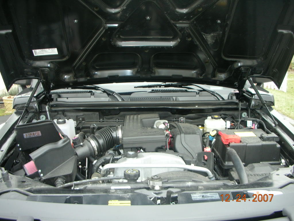

Bashing the competition is not what I do, but I will say a couple things about an Airaid. First, they make a very fine filter, even though I prefer K&N, just MHO.
Next, they did not finish the job! Here is what I mean: Airaid has a excellent quality filter, but tries to make its power gains through and open air filter box
(lid removed) with the barricade in the corner behind an added on metal with rubber to hood seal. The idea being that the partitian closed off by the rubber
moulding the surface of the inside of the hood isolates the rest of the underhood engine heated temperature environment allowing the intake to catch an increased
volume of air concentrated from flow behind the headlight/turn signal area of the grill.
A picture speaks volumes. Courtesey of rhill20: his H3.
I do not have a lot of faith in that approach, but more importantly, Airaid left the factory intake hoses and throttle body resonator box in the system. That chunk of factory intake does rob power, no question.

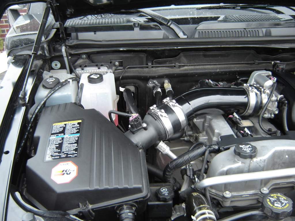

The AirDocIntake uses a 3.5" diameter smooth steel pipe with mandrel bend to increase air flow once taken in as the source of the motor's combustion air charge. The lid stays on the box, all the rest of the factory intake hoses, resonator box, and air filter box inlet snorkel tube are replaced with all stainless clamps and 4 ply silicone hoses. Substantial overkill for an intake, but isn't a Hummer overkill for a truck? Take a look. The air is grabbed from outside the underhood heat, through the factory fender hole to the inner passenger fender. Stays cool all the way into the throttle body inlet.
Get a filter of your choice, get this kit, and you will smile at about $200.00 or less! One of the BIG Three down, two to go.
