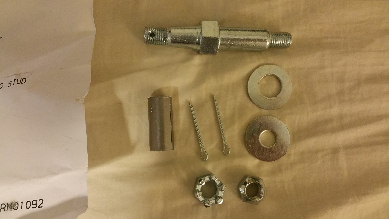

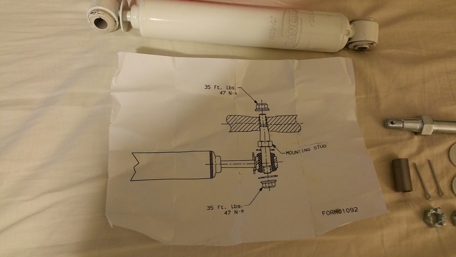

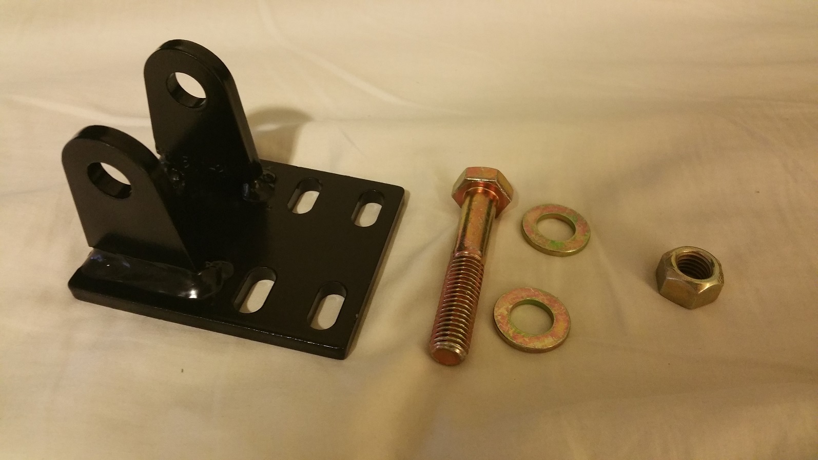

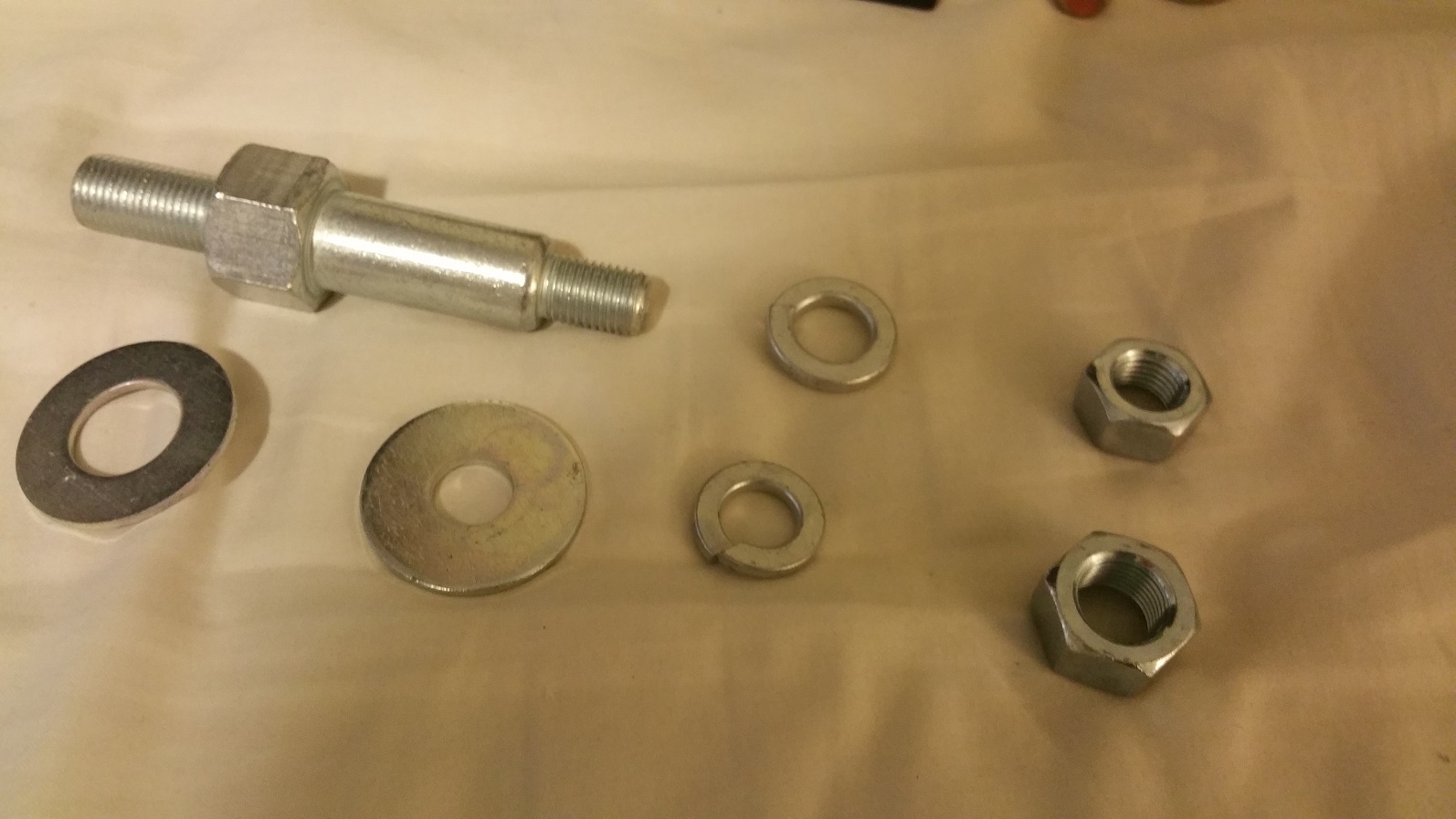

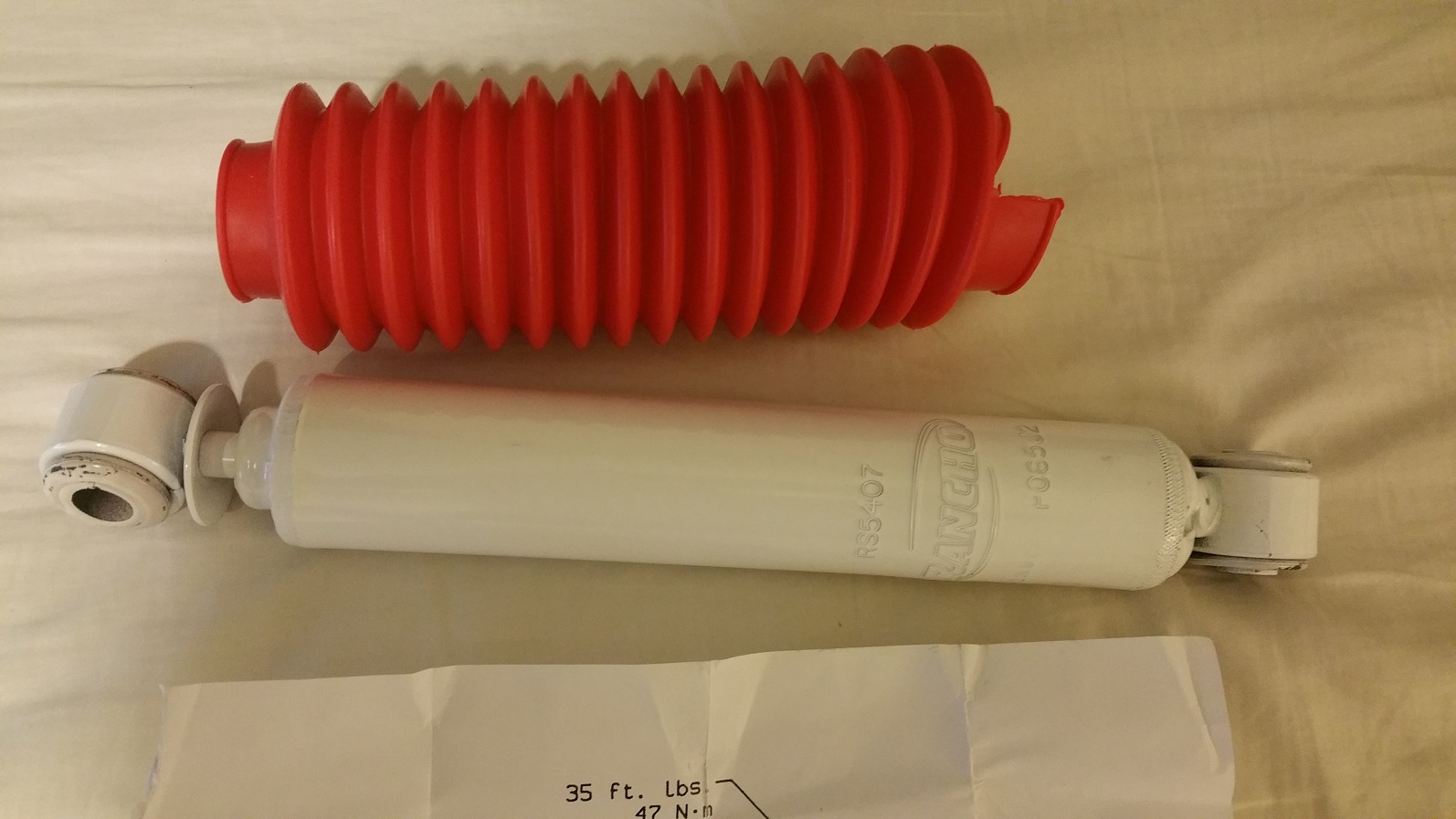

As a recap, I ordered the racho 5407 stabalizer & the mounting kit.
Here's what comes w/ the stabalizer itself.
Here's what comes w/ the mounting bracket.
As you can see, the mounting hardware differs. The shock comes with a longer bolt that has a hole for the included cotterpin & a castle style nut to fit.
The mounting hardware itself seems extremely heavy duty. I'll have to compare it to what GM provides. Interestingly, there's no u bolts included. If they snap, I'll have to run out to get new ones... I am not pleased about this considering the mounting kit was almost the price of the stabalizer itself.
I'll be installing it this evening, hopefully.

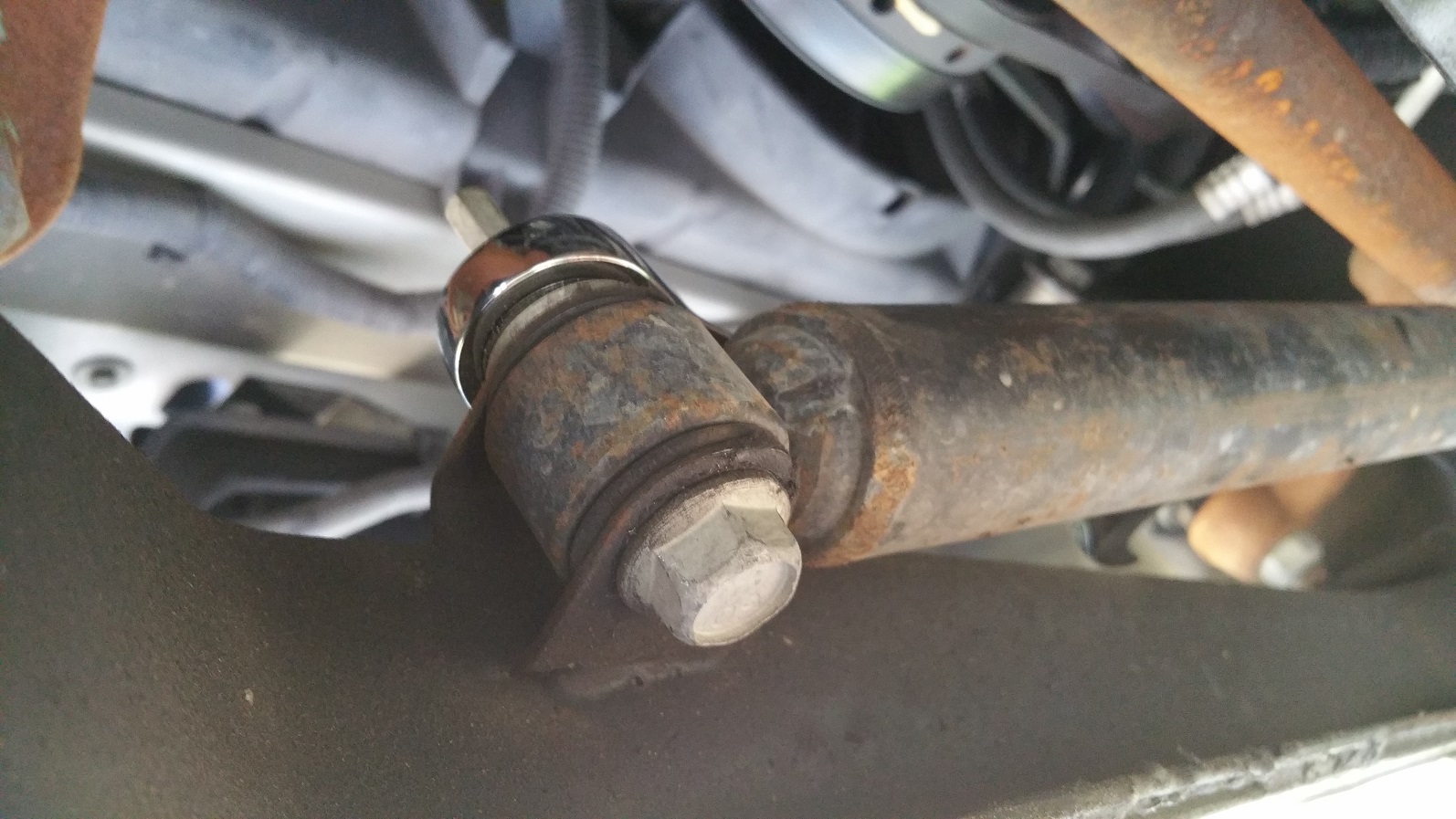

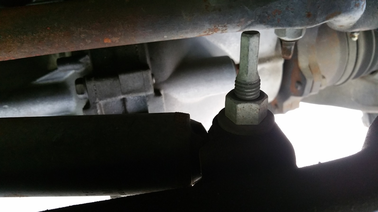

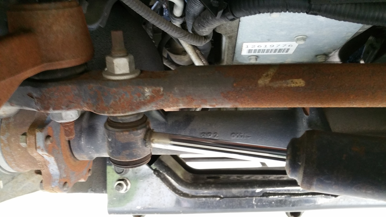

Well, that was a failure. Can't get it off. I'll clear up some stuff for a few 08/09 owners & hopefully get some feedback.
First, the mounting kit isn't necessary. Does anyone need one for an older model hummer?
Second, my steering stabilizer seems ok (has the same reistance extending the piston or compressing it). I'm not sure how much resistance I should have, so I still want to install it.
Here's some pics.
The arm of the shock mounting location:
The piston side of the shock mounting location: Warning, dark, but this mounts to the frame.
Ok, picture time is over.
The bolt on the piston side easily comes off. You just need an 18mm wrench & 18mm socket to remove the bolt. Simple, easy.
The bolt on the arm side is impossible. I removed the nut & nothing. The bolt is welded to the stabilizer. In my case, it won't come out. Hit it with break cleaner & took a pry bar to it. Absolutely nothing worked, It won't budget & the piece it's mounted to began to slightly bend, so I let up.
The top of the bolt has a hexagonal shape, but I don't think it's used to remove the bolt/stabilizer.
Anyways, ideas for how to get this out w/o breaking anything?

Amateurs....lol
You need a "PICKLE FORK ", to remove the tapered bolt, from the Centerlink..
The right tools AND experience go a long way..
Get the tool, and it should come right out...
