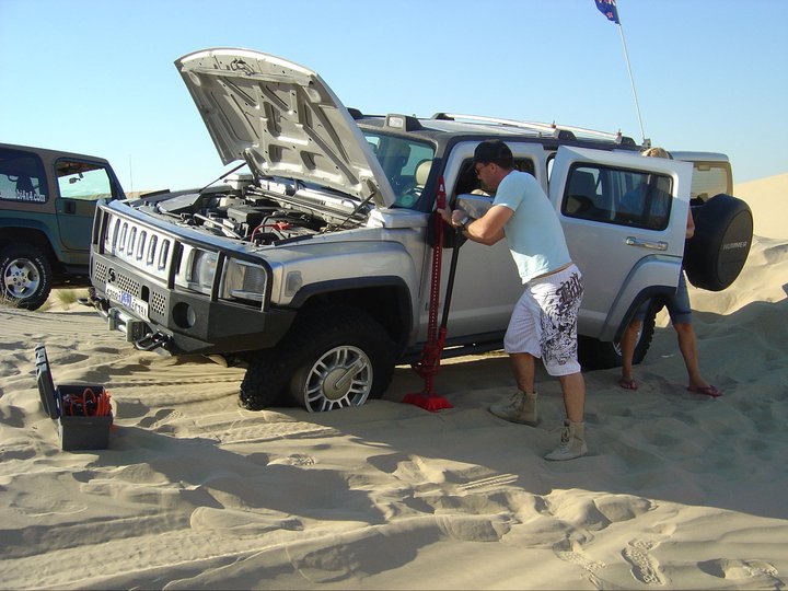

I have BFG 285/75/16, every week in the sand dunes, front and rear at 10psi, sometimes down to 8psi if in really soft sand area..then still room to drop a little more in necessary(not needed yet).....only 3 popouts in as many years (touch wood lol..)...
As stated below depends on the tires you have and how rigid the sidewall is...where and what you drive on and importantly your driving style...
