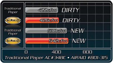

here it is the info provided by Airaid .. notice this is a dry filter , the oiled has much better air flow
Thank you
Thank you
