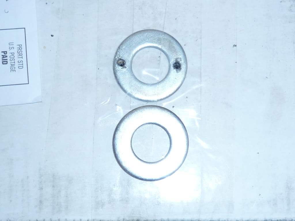

I had the same problem a few months ago. If you don't mind drilling into your plastic, you can make a very solid cargo retainer clip by drilling two holes through a washer of the right size and putting screws through the washer and factory clips, while retaining the center for the net. See photos:

What a great idea, Paladine 71, thanks!

Here's the exploded diagram for this part - item 014 in the diagram (GM # 10414612):
N1 TRIM/INTERIOR-BODY SIDE REAR; N1(06) TRIM/INTERIOR-BODY SIDE REAR;. Fits: H3 , H3T | Nalley Buick GMC Brunswick
However, Paladine's DIY solution is stronger & will last longer.
