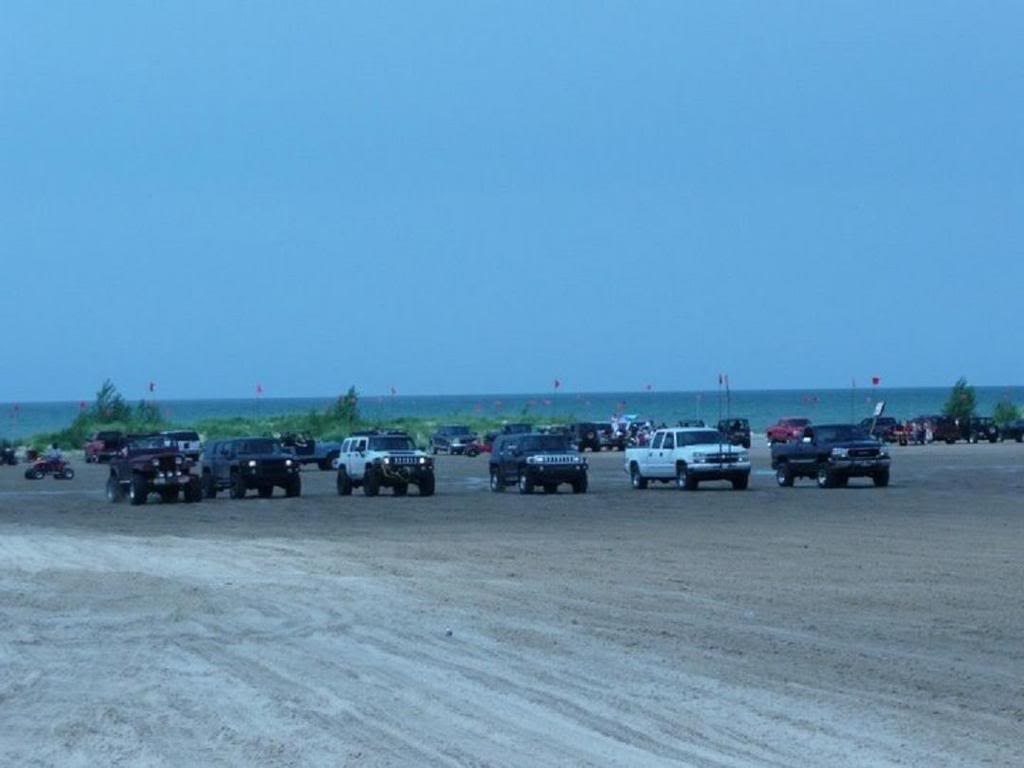

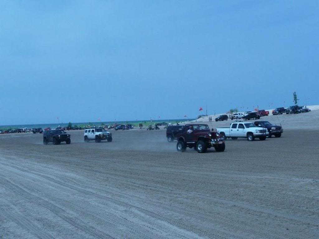

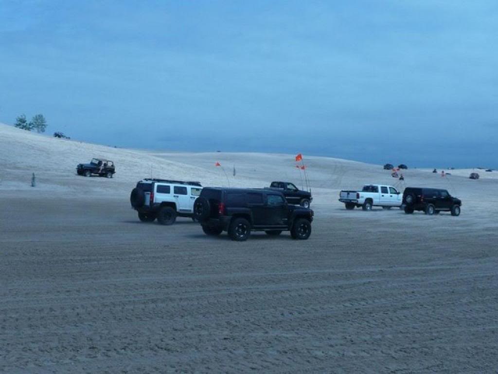

The real hard proof IMHO is sand drags, two H3s (an 06 and an 07) stock, one 2007 with the H367. It ain't hard to figure which has the intake. These are good friends, and I assure you they were trying their best to kick my butt. Note the V8 Silverado, I could almost get him too. We did this three times, the results were always the same.
