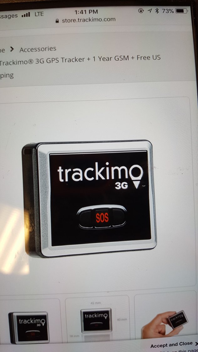

Thanks again everyone! Which tracker was your friend using for $5 a month? I would cancel my OnStar subscription since I don't think it even works anymore with the older systems and pay for a tracker.
Old May 13, 2019 | 12:45 PM
madmayo's Avatar
Joined: Mar 2014
Posts: 356
From: Belwood,Ontario , Canada
This is the one my buddy has.
