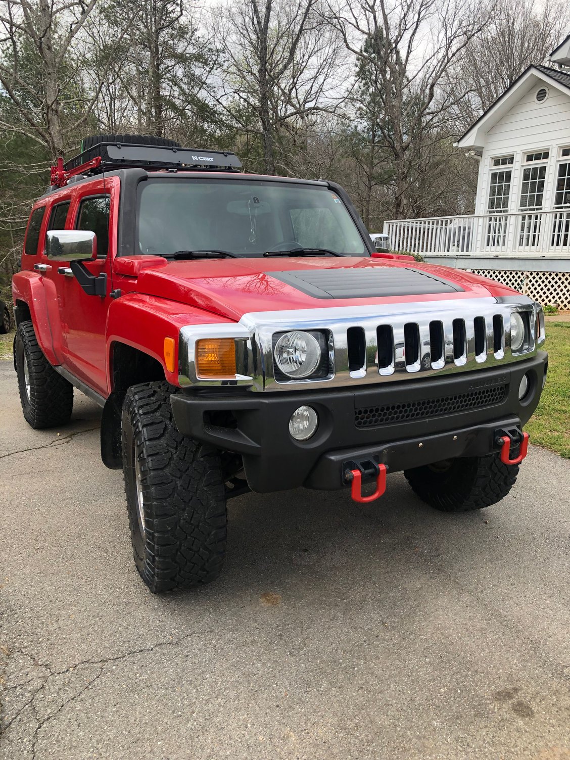

I just got some new 35" Duratracs for my '09 H3T Alpha Adventure and wanted to know if anyone has had any issues with a 35" spare rubbing the rear sway bars? Thanks for any help!

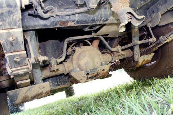

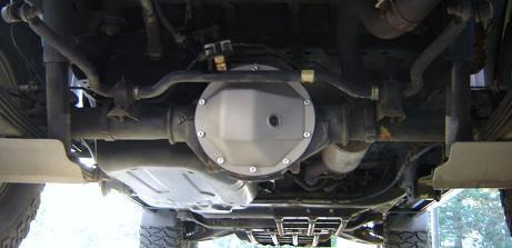

AS you can see below the H3 sway bar is in the middle of the diff cover while the H3T bar is above the diff.
H3: Image is from Doc Olds
H3T: Unknown image reference
