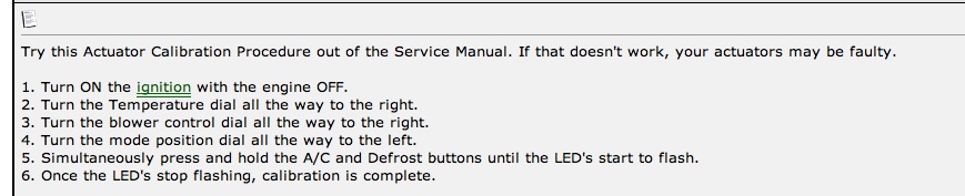

If I remember correctly
Temp **** all the way to hot
Fan speed on 4
Right **** all the way to left
Push and hold left and right **** until they start to flash
System will cycle through all modes then it's calibrated

BruceS instructions are correct, but here is another version
