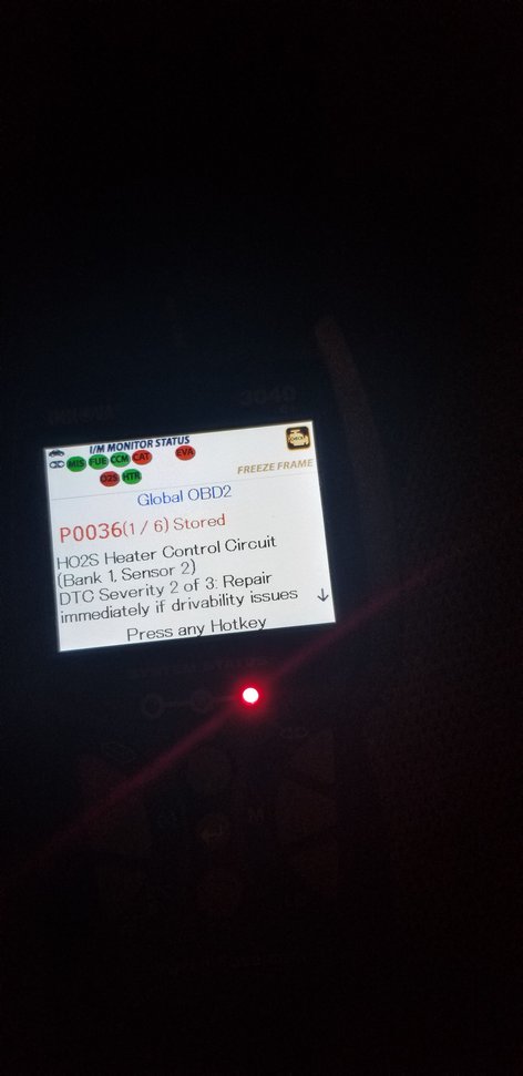

So I have a stalling problem only once truck has gotten to operating temperature. It also does a chugging motion and it only does all these things at a stop. I have replaced throttle body and mass air flow sensor and temperature sensor because I once had codes for those. I just tryed using seafoam top engine cleaner today on my intake manifold seems to run alot better but it didnt fix my stalling issue maybe someone experienced this and knows exact fix

Did you replace the O2 sensor, as per your DLC codes?

Yeah just couldn't replace the 1 in the exhaust it's pretty seized in so I stopped bothering with it being it just monitors the cat. I believe my problem is the vvt solenoid I bought a off brand not ac delco and I'm guessing this 1 just gave up after a few months last time I buy off brand products

For the P0141, replace the oxygen sensor in the exhaust manifold. I did this a few months ago and had a hell of a time. I rented the specific socket, only to strip the sensor. That happened even after several days of PB blaster getting sprayed on it. I then took my dremel and removed the body of the sensor, leaving only the rounded head. I took a socket and hammered it down onto the rounded head, and removed it (needed a large cheater bar at the right angle). Hillbilly removal for sure, but it worked without damaging the manifold.
