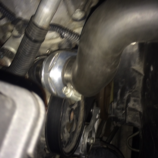

I gutted mine and put it back on. I now run an in-line thermostat on the top hose. Much easier to replace in future. That being said, I was able to remove and reinstall from the bottom. Tight but doable with 1/4” drive wrench and deep socket 10mm.
Attached Thumbnails 2006 H3 Thermostat-eac325a2-526a-4fdf-a05f-cf887a066ff4.jpeg   2006 H3 Thermostat-609c69bf-9d36-406a-9c5f-20396b228e51.jpeg   2006 H3 Thermostat-b30bb840-bedb-4ac4-b05e-d60673cf3a5d.jpeg   2006 H3 Thermostat-43244f36-61c1-4536-8937-e1897ef58e7c.jpeg
