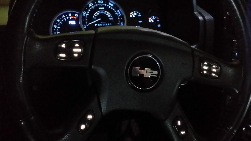

What lights on the steering wheel controls are supposed to be lit up? I know the top ones are supposed to be lit. My bottoms ones aren't...

They should all be lit up. Here's the best pic I could get. These are after I changed all my dash lights to LED.

Those dash lights are very cool, what exactly is involved? As far as the steering wheel I know u have to buy the whole switch, u can find them on eBay for like 100 bucks for all of them. I myself have about 3 of them out, a summer project.

I read this and then noticed my lower left ones are out
I have the same issue...see them on eBay for under $30 shipped seperatly or $100 for all 4.
I disassembled everything in my dash, doors, etc and replaced them all with LED. I was tired of the nasty stock yellow colors. All the wheel controls, door buttons, dash buttons all have to be soldered in but it wasn't that difficult. Biggest pain was taking the radio apart but I had worn buttons so I replaced those at the same time.

I just replaced all 4 switches... real easy to do
Did u have to solder them? I have no patience for solder hehe

If you are replacing the entire button pack x4 then you don't need to solder. Just pop the old one out, unplug it, plug in the new one, and push it into the steering wheel.
