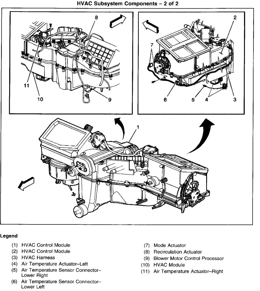

1. Passenger side A/C blows HOT air regardless of turning the passenger climate contol temp ****. Driver side blows COLD air?

1) theres a blend control motor that adjusts between hot/cold, probably took a dump.
#11 I believe
A scan tool should be able to diagnose a non-responsive actuator.
