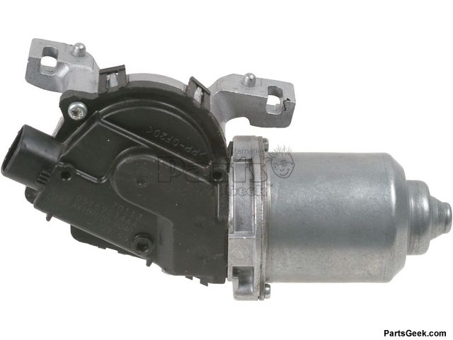

Smile Wiper issue fixed on my '07 H3
Problem: Wipers would cycle when Ignition key was turned on but would not "Park" correctly. Wipers worked on High, but would not "Park" correctly when turned off. Wipers would work on "Mist", but again, not "Park" in the correct position. No Intermittant or slow speed wiper function at all.
I finally got the Wiper problem fixed on my '07 H3 after much agony.
Here is the history: I replaced the wiper motor, No change.
Replaced the column switch, no change.
Replaced the BCM, no change.
I gave up and took it to the Dealer and they replaced the underhood FUSE BOX that had a short or something wrong with it.
Another Wiper motor was required as the bad FUSE BOX ruined the new wiper motor.
In short, the problem as a Bad Fuse Box. Go figure. All is well now.

I had the same problem. The wipers move up and down five times and stop at random places on the windshield. I took it to the dealer they said it was a body control module. I did a lot of investigating first before it's going to pay for that repair. I ended up putting a wiper motor in twice. The first time I replaced it, the problem continued again. (Remanufactured motors, they check the component inside but not the module apparently) I ordered another motor. When I received it, the outer casing was broken. I took the module off of the broken motor and put it on the 1st replacement. That fixed it and It worked great for many years!

I had the same problem. The wipers move up and down five times and stop at random places on the windshield. I took it to the dealer they said it was a body control module. I did a lot of investigating first before I went with that repair. I ended up putting a wiper motor in twice. The first time I replaced it, the problem continued again. (Remanufactured motors, they check the component inside but not the module apparently) I ordered another motor. When I received it, the outer casing was broken. I took the module off of the broken motor and put it on the 1st replacement. That fixed it and It worked great for many years!
The problem was the WMCM (wiper motor control module), very common with symptoms noted.
