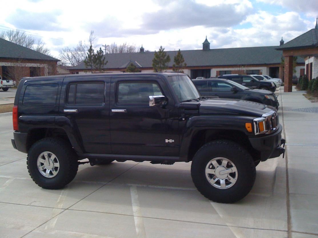

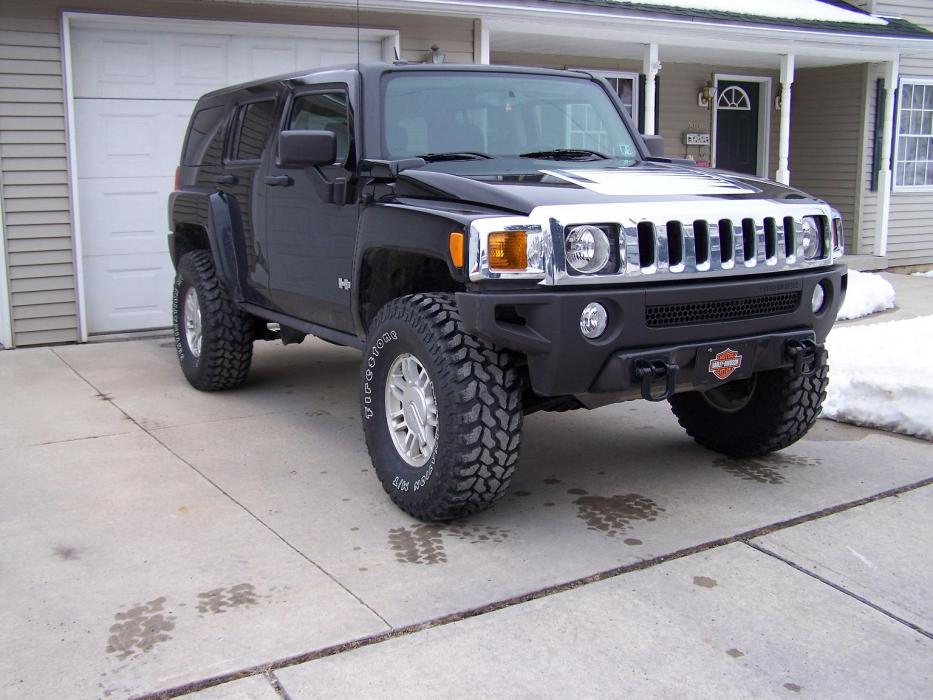

Finally had a chance to rinse some of the road salt and snap a few pics. I'm at 23.75" hub to fender and runnin 35" Firestone MT's. Exhaust and Airdoc are waiting for a warm day. Bilstein's w/ bumpstops are on the way.

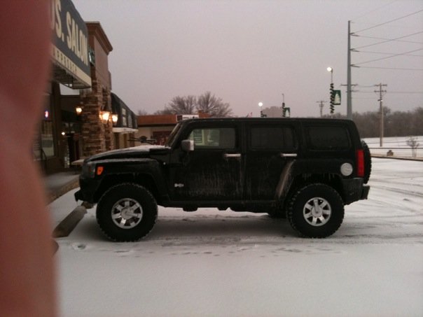

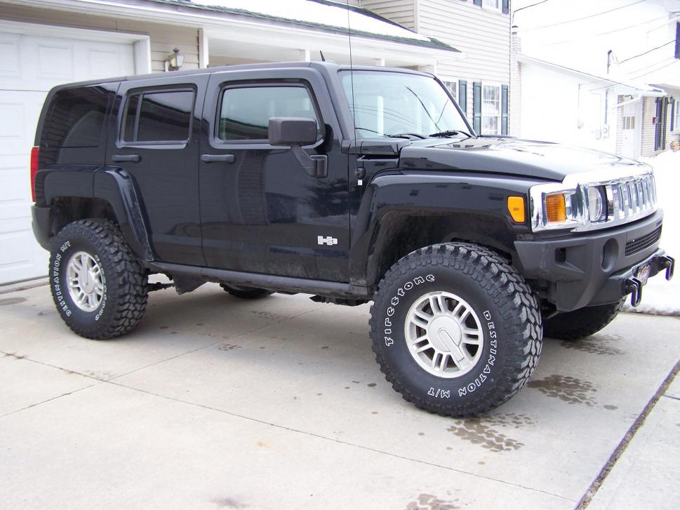

looks very familiar... very nice. Let me know if the shocks and bumps make much difference.
Attached Thumbnails 07 H3 leveled w/ 315's-img_0494.jpg   07 H3 leveled w/ 315's-h3snow.jpg
