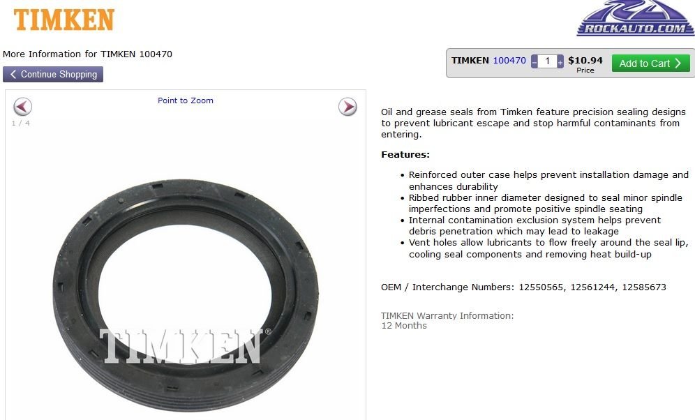

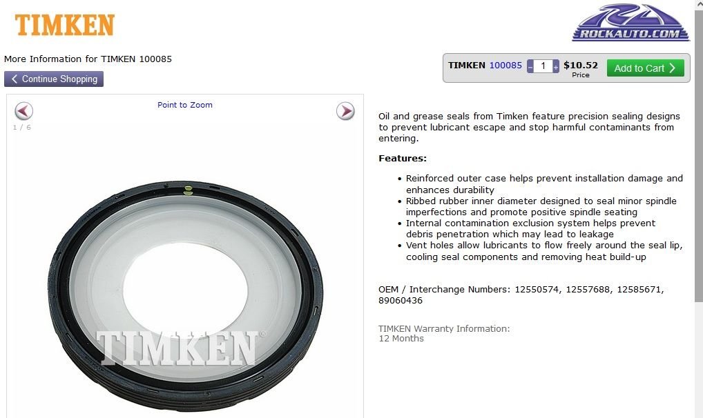

Timken manufactures the oem seals(compare the price, same part different label)
front and rear:

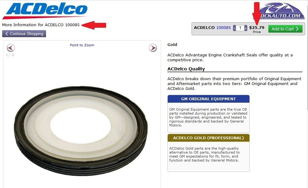

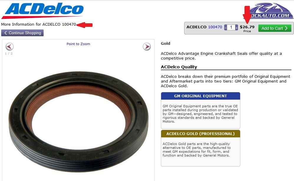

Look @ what happens when Timken 100085 & 100470 uses the blue label box:
