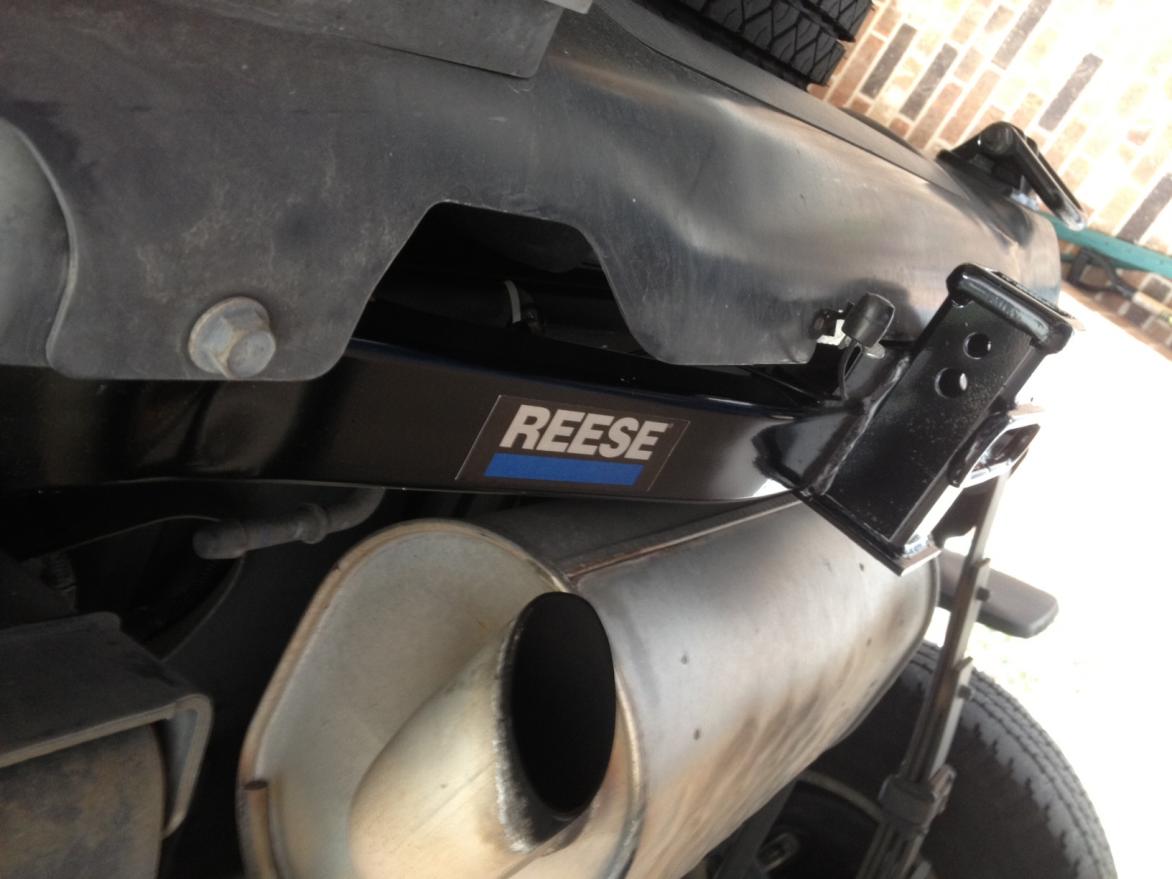

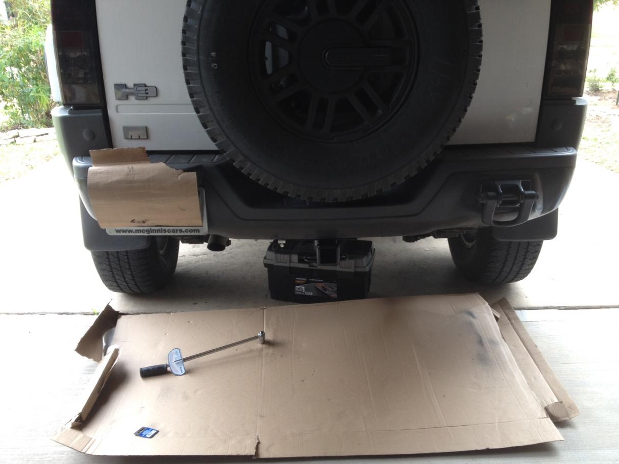

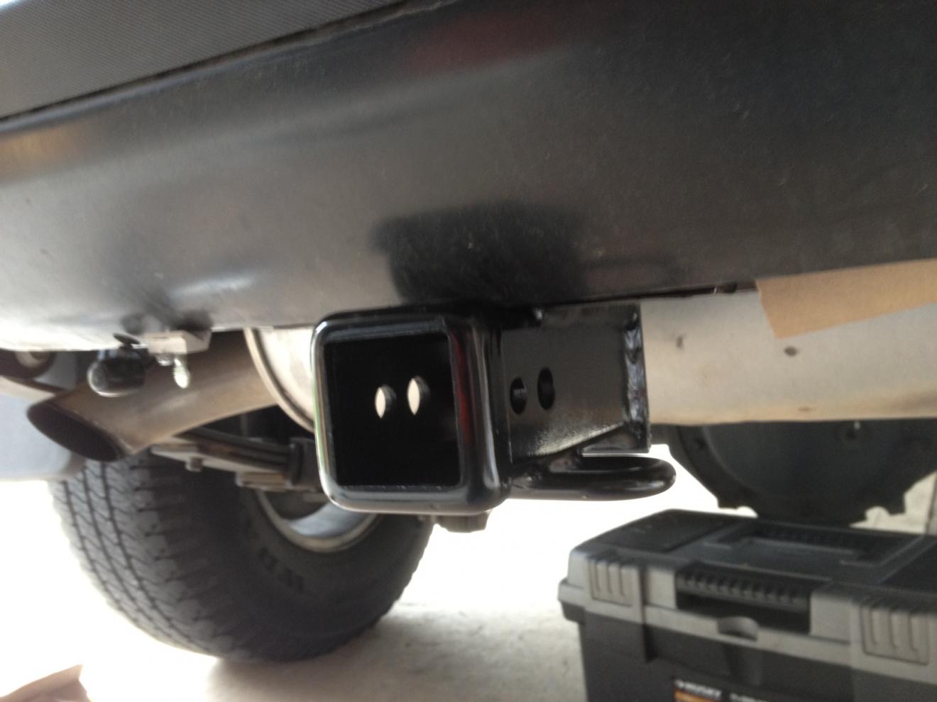

Just installed the REESE hitch and I happy with fit. The One thing I noticed is that the paint on this hitch chips very easily, I was even being careful during the install and any minor bump would cause the paint to chip off. I had to touch up quite a few spots with black spray paint after the install. I had to slide my backup camera over a little since it was mounted in the same place as the receiver.

thanks for the heads up! Ordered mine, just shipped today......thats a deal and a half.....was it true bolt on/no mods?

I can't believe that it cleared the non tow package bumper. Looks good.
That is good to know for peeps adding these in the future.
Other hitches require you either cut the bumper or swap it for the tow package bumper.

When I put a Reese hitch on my old Jeep, it fit well. The paint was thin like mentioned above. I always has to touch it up.

put mine in....20 minutes, piece o' cake...remove 4 bolts, reuse to secure hitch. What wiring.....I dont want to cut any wires
