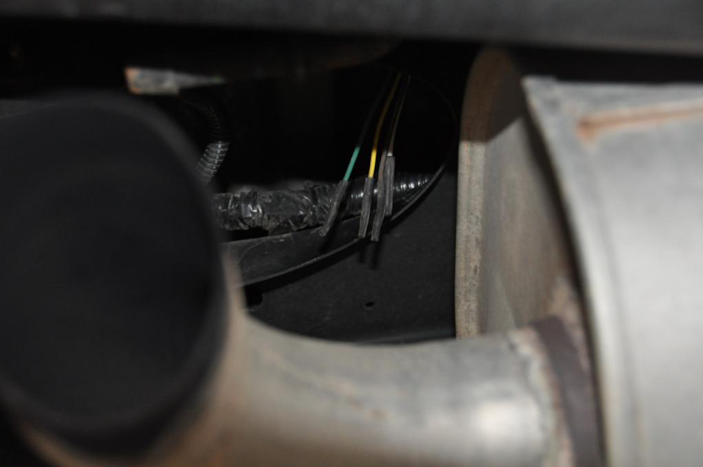

The wires on mine were not between the bumper and the body at all. They were under the body on the driver's side up in a large hole next to the "tip" of the muffler. I took a couple of pics this weekend prior to hooking up my harness. I'll try to post them up tonight if I get a chance for reference.

Hopefully, this will help in case yours are where mine was...
Attached Thumbnails hitch wiring harness-dsc_7956.jpg   hitch wiring harness-dsc_7957.jpg   hitch wiring harness-dsc_7958.jpg

JDuncan, thanks for the pics! Not sure I would have looked that far back. That helps a lot.
