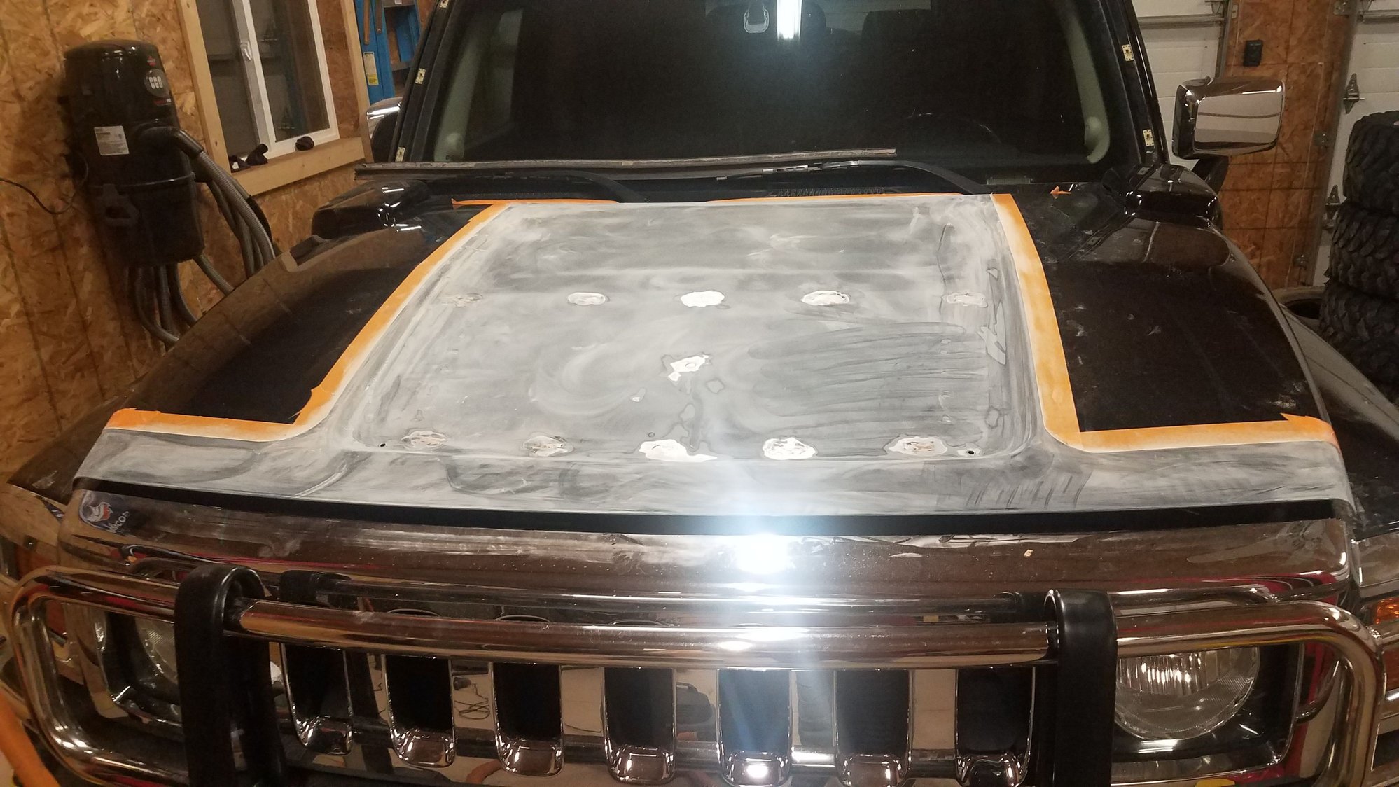

removed the chrome fake louvre vent thingy on hood, made blanks and braised the holes shut with silicon bronze, sanded and body filled, finished in four coats of raptor liner and four coats of satin clear, left the drain holes

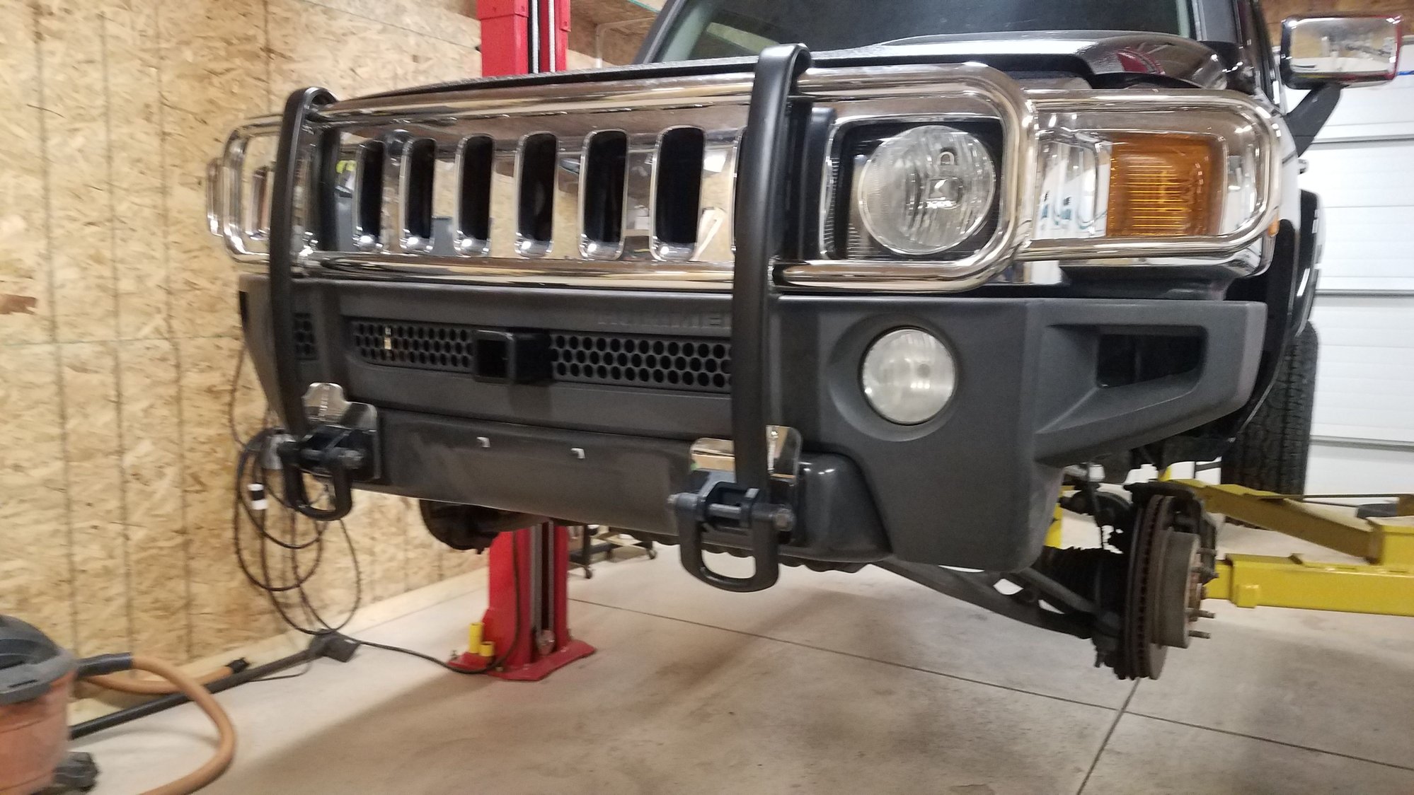

fabricated and installed hidden receiver/winch mount behind grill (I actually have a new design that I will fabricated this next week, same look and function but will be a bit cleaner as I used scrap in the shop for the first one, 2x2 1/4 inch steel, bolted into the frame using 1/4 inch steel angle and grade 8 hardware. When i refabricate I'll post pics, its clean and would be easy to replicate,

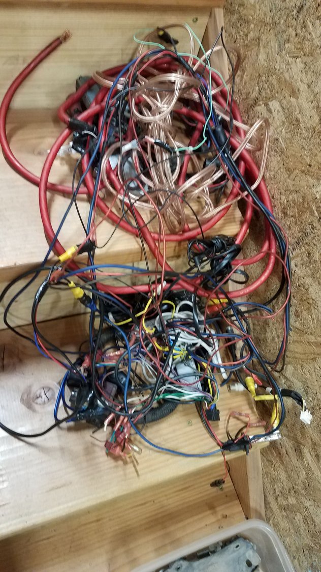

removed a rats nest of unnecessary wiring, I'll post a photo, it's a little crazy

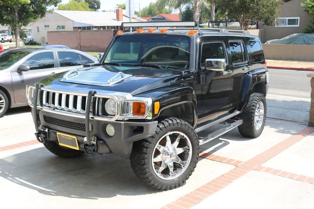

What I bought:
Hood vent removal:
hood refinished:
for those of you that do your own work on the hummer this is for laughs, all this junk was just installed and hanging around, everything from crappy lighting to extra stereo stuff....
winch point installed:

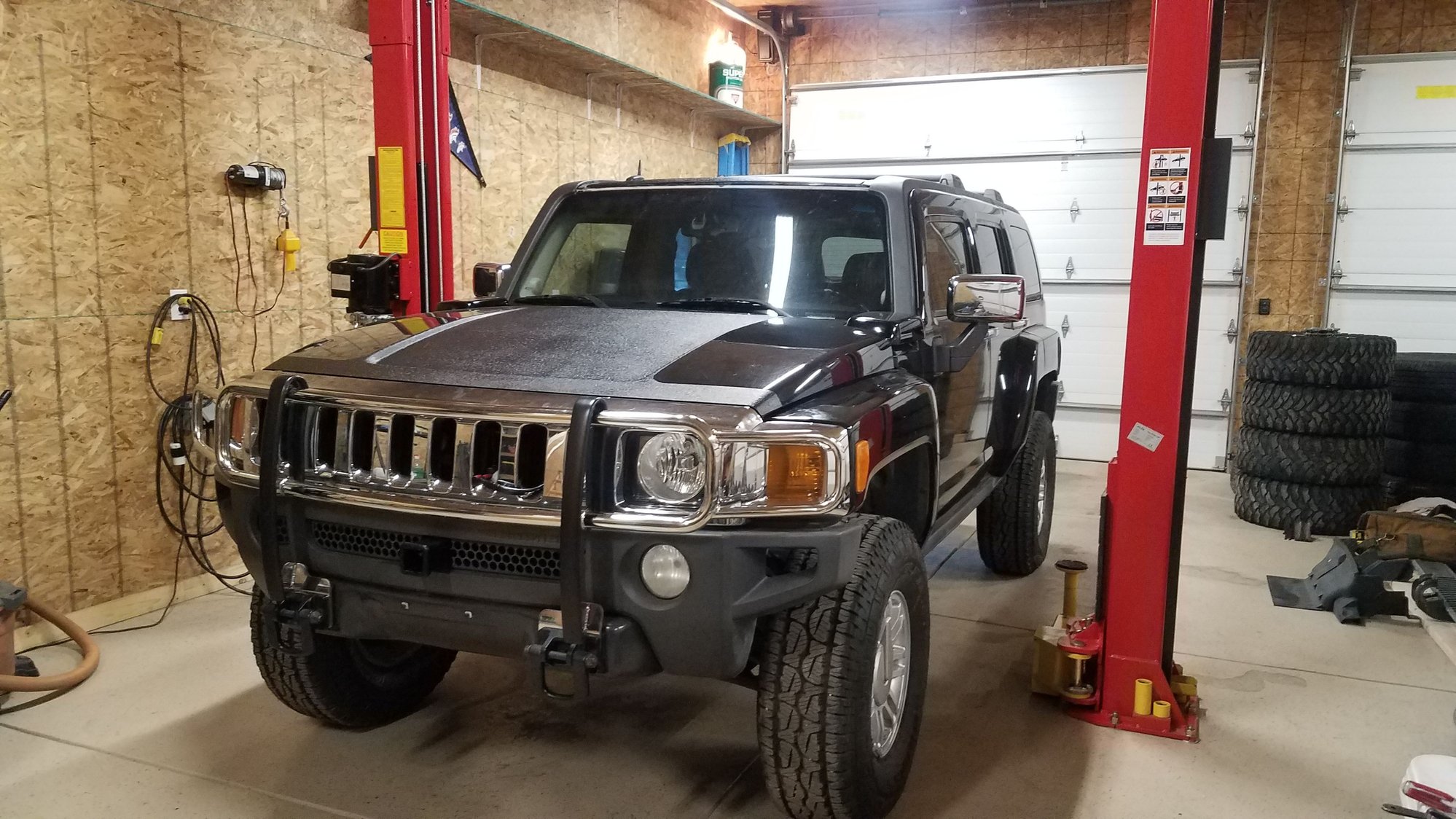

nearing competion:
