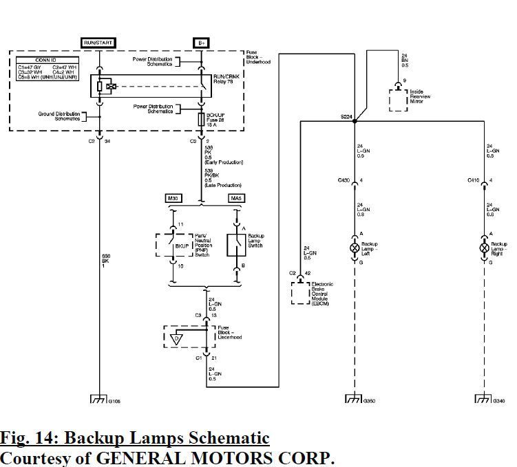

It gets weirder. I put the original BCM back in just to see. Now the key fob receiver is working again! And the rear defogger works. And the turn signal indicators don't come on when you step on the brake. But the right rear backup light works and the left one still doesn't. I checked the left side bulb and it's good. I have a schematic for the 2007 H3 but I'm wondering if it's the same as the 2009 because it doesn't even involve the BCM.

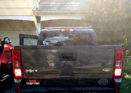

Solved! I gingerly pushed the wires on the BCM's gray connector towards the plug housing and tried putting it into reverse. Both backup lights now come on. And the rear defogger works. And the key fob works. And the TPMS junk all works. Everything works. Finally. And the ultimate irony is that this is with the original BCM. The one that Valley Cadillac told me was defective which is what started off this year long stupidity. Thanks to everyone here for following along.
Both backup lights now work.
