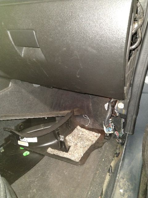

About two months ago I got water leaking down the passenger side A pillar from the sunroof of my 2009 H3T Alpha. It apparently got into the BCM and suddenly my key fob only worked if I held it right next to the passenger door., although everything else the BCM controls was fine. So I took it to the dealer I bought it from in 2008. We'll just call them Acme Motors - that's not their real name. (Their real name is Valley Cadillac). They had it for a week and finally informed me I needed a new BCM, part no. 20987862 but that part was discontinued by GM and they couldn't find a new one but if I could find a used one they would put it in for me.
So I went to the local junkyard and they found me a 20987863 which they swore the computer said was a cross for the -62 and that it would work. I bought it and took it over to Acme. Another week later the6y called to tell me that module was no good and the truck wouldn't even start with it in, so they put the original BCM back in. So I went on Ebay and found a correct matching used -62 part number. Another week later it arrived and I took it over to Acme. After still another week they called to say this module was also no good. They said you couldn't put a used BCM in the Hummer because the VIN is hard-coded in the module and can't be changed and that's what it didn't work (which I believe to be a bunch of baloney).

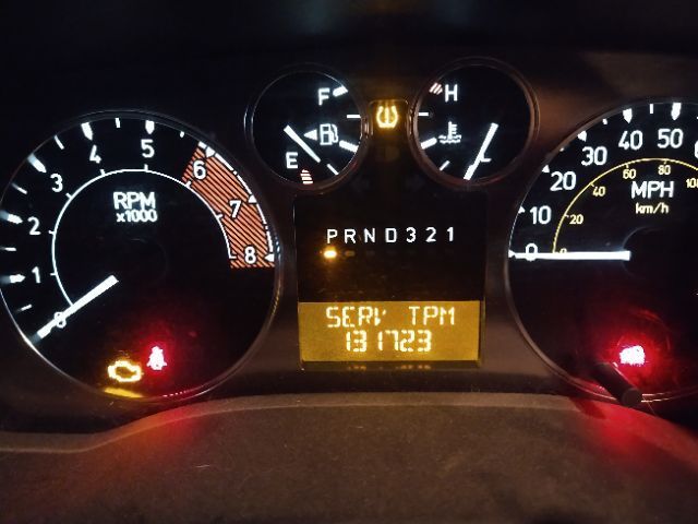

So they put the original BCM back in and apparently having tired of me told me to come by and pick up the truck. When I got home I took a look at the odometer. It was reading 29,972 when I took it in. Now it's reading 174,793! And it's not rolling, so it's stuck on that number. And now the trip counter also doesn't work. It's stuck on zero. And it says I need an oil change, which I don't.

Knowledge is power, get some by reading about H3/H3T BCM replacement. There are some threads here and on the web. Yes you can swap in a used BCM and it can be programmed with a Tech II or equivalent tool by an actual technician that knows what they are doing, but.... The odometer gets the miles to display from the BCM storage. So you odometer will be at whatever the donor truck had on it. That is where the new one comes in.
Did you get your parts back from them? They did not put your original BCM back in and you know that because the miles are displayed from a replacement. You can buy a BCM and have it programed to your vehicle by mail order as well (nut shell: you send your old bad BCM and they copy it over - clone it - to the replacement). There is a pretty recent thread on how to clean the BCM and tweak the antenna for better OEM Fob function.

Ah yes, I guess everybody has 20/20 hindsight :-) I should have discovered this forum years ago. The idea that they put the wrong BCM back in was good, only they didn't. I checked the serial number of the used one I bought and it matches the part they gave back to me, so the one in the truck now is the original BCM.

So this is where we're at. After some discussion Acme has agreed to take it back in. Fortunately, they have an official record of its actual mileage taken direct from the OBD2 when I brought it in. They're going to send that, along with the original BCM and the used one I bought to Garrett Tuning in Ohio for cloning and odometer correction, and then put the cloned BCM back in the truck. Then *hopefully* everything will work again. But then again hope and a nickel will buy you a cup of coffee (it's a very old saying. We'll see...

Well this whole sorry situation is rapidly going from bad to worse. After putting me off for over a week for the holidays, I called Acme, oh the heck with it, I called Valley Cadillac yesterday morning. Dino, the service adviser didn't answer. I left a voicemail. Two hours later, no call back so I called the service manager. He didn't answer so I left another voicemail. No call back. So finally I just drove down there and cornered Dino. He informed me that Valley Cadillac was washing its hands of the whole deal and walking away. He refused to do any more work on the truck. This is how they left it:
H3T BCM extraction
H3T BCM extraction
H3T corrupted odometer
So now I don't know what to do. I suppose I could unplug the BCM and send it to Garrett for cloning with the new used one I got last month. But it appears the corrupted mileage has propagated to the instrument cluster due to Valley's incompetence. Do I need to send that off too? I have no idea how to do that. They need to correct it to the true mileage (30,277). Then I'll have to rent a car while Garrett patches everything up. Oh and the check engine light is still on, after they charged me $1200 to fix ("Replaced Evap Vent Solenoid") ARRRGH!
