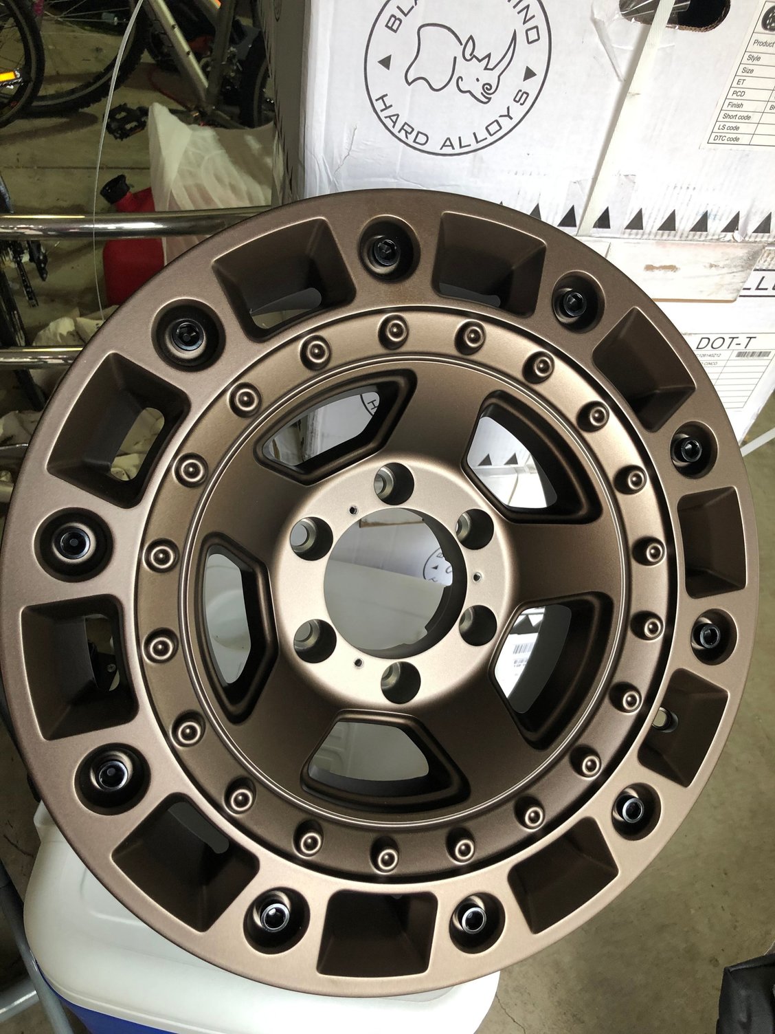

So I've had my old/new 2009 Alpha H3T since this July. 107,000 miles and one owner. This forum has been the BEST in educating myself on the H3T, what others have done, and with the only regret of not holding out to find an Alpha with the Adventure Package. Now, every time i see an interior photo of one, the first thing I look for is the extra two buttons on the console! Its driving my nuts. But, I'm well into my upgrades and since getting it (not in order) I've replaced the total cat system from header back, including a new Magnaflow exhaust system (made an investment in a OBD2 reader and got errors on the catalytic converters and sensors). Thanks to @Hummerz and @Bronxtech I had the front and rear differentials serviced (hadn't been done in years, according to mechanic). Replaced all the rotors, calipers, and brake pads with a performance kit from Power Stop (should have upgraded the lines to braided stainless steel, but totally didn't think of it till too late). Upgraded the Air Flow system to K&N Filter and the kit from Air Doc Intakes (which combined with the exhaust, really has the hummer sounding amazing). Cosmetically, I changed all the headlights, flashers, and foglights to LED, replaced the corroded gas tank cover, refurbished the front bumper chrome bar with bed liner spray from U POL Raptor, and actually found a Ziebart place to treat all the surface rust underneath and update the spray undercoating (makes the chrome of the new muffler and exhaust really shine against black vs. rust!) Also, replaced all the interior speakers with modern sound, a new Kenwood monitor/head unit, deadening in the doors, 500 watt amp under the drivers seat, and a 10" powered subwoofer under the rear seat (I still don't know where to reinstall the OEM tire jack and stand, but I'll figure that out later!).
This has kept me busy and happy while my suspension kit has been on backorder for MONTHS!! I must must have 35s installed, and though I've read everything I can about rubbing (or not rubbing) I didn't want to pull the trigger on bigger rims (I went with a set of five 18s from Black Rhino) or tires (I'm still deciding between BFGoodrich K02 ATs and Mickey Thompson ATs in a 35x12.5x18...and apparently the Hummer EV is using a new Goodyear Wrangler Territory AT tire, so that's got me intrigued too) until I found a way to get a 2 to 3 inches in space. I was definitely going to do the torsion key adjustment, but somewhere I got hooked on the Old Man EMU kit and it FINALLY arrived today (see photo). It comes with front and rear shocks, rear lift springs, and a set of torsion bars. Torsion BARS?? I was expecting new torsion keys, so the bar thing is throwing me off. Right now the plan is to have the kit installed, since it's all OEM equipment replacement and everything I've read is that it keeps the original balance of the H3T stable. I'll measure the center hub and fender after the install and see if I need to adjust the torsion keys to get to the famed 23.5" in the front wheel wells.
Hopefully I will NOT need any spacers or something stupid to make this rim (bought) and future tire setup work and look good. I go ga-ga every time I see a awesome photo of the forum members H3s with 35s on them. I probably should have gone with 17s instead of 18s but too late now. And I still haven't figured out where the heck this 5th wheel is going! I have a hard diamond pattern lockable cover on the bed so I was thinking about installing a rack on top of that...versus putting it on the roof with a roof rack. No way it fits where the current spare sits!

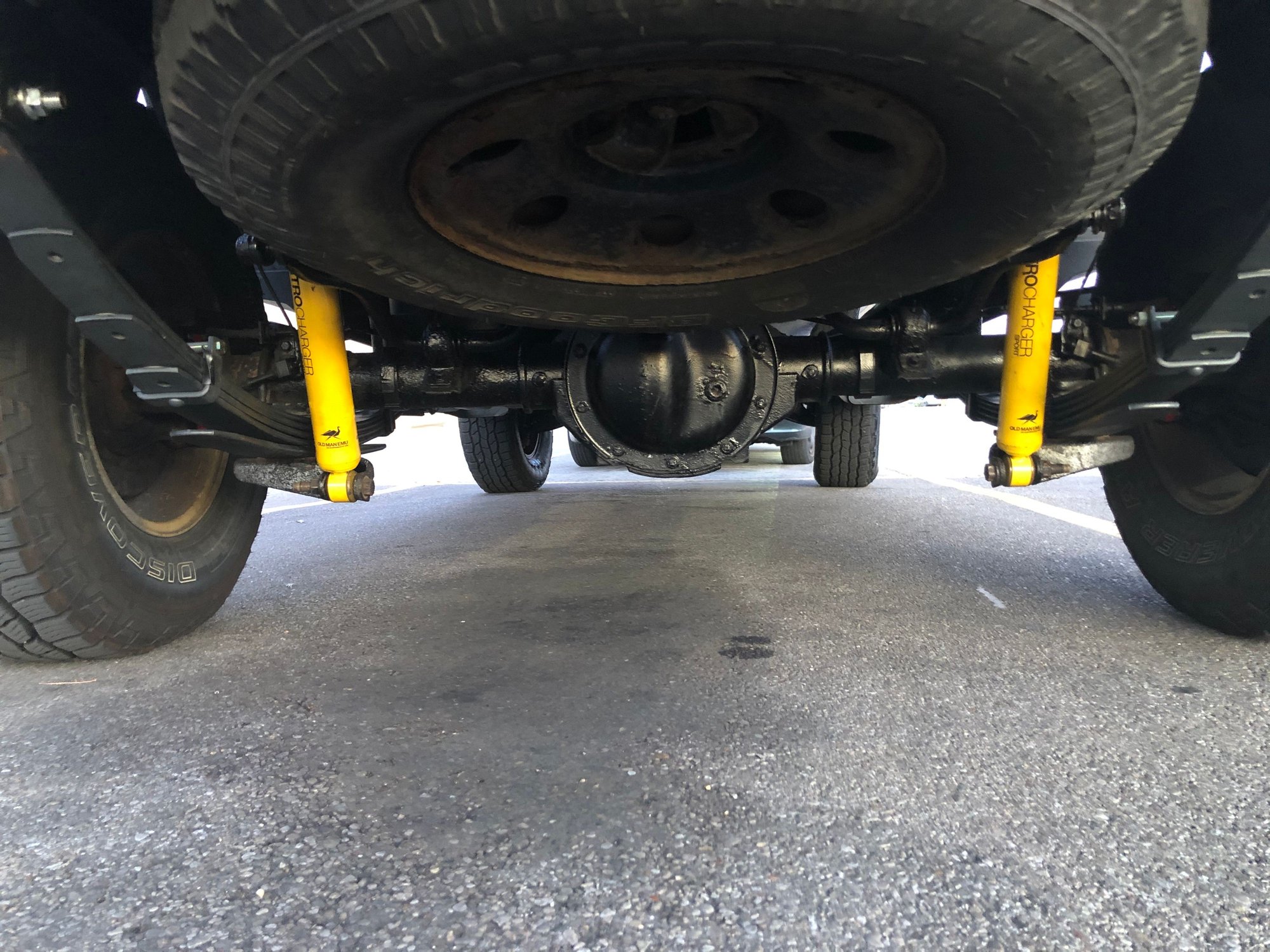

Good stuff. You do not NEED any keys or shock extenders as the OME T Bars are just a bit beefier than stock. Your stock keys provide all the lift the front can handle. Great replacements for any Alpha.

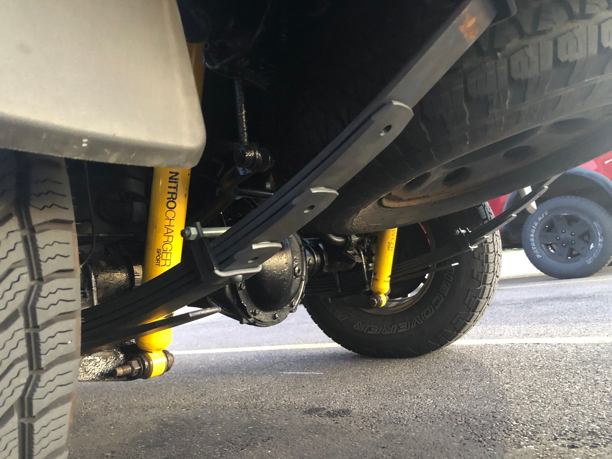

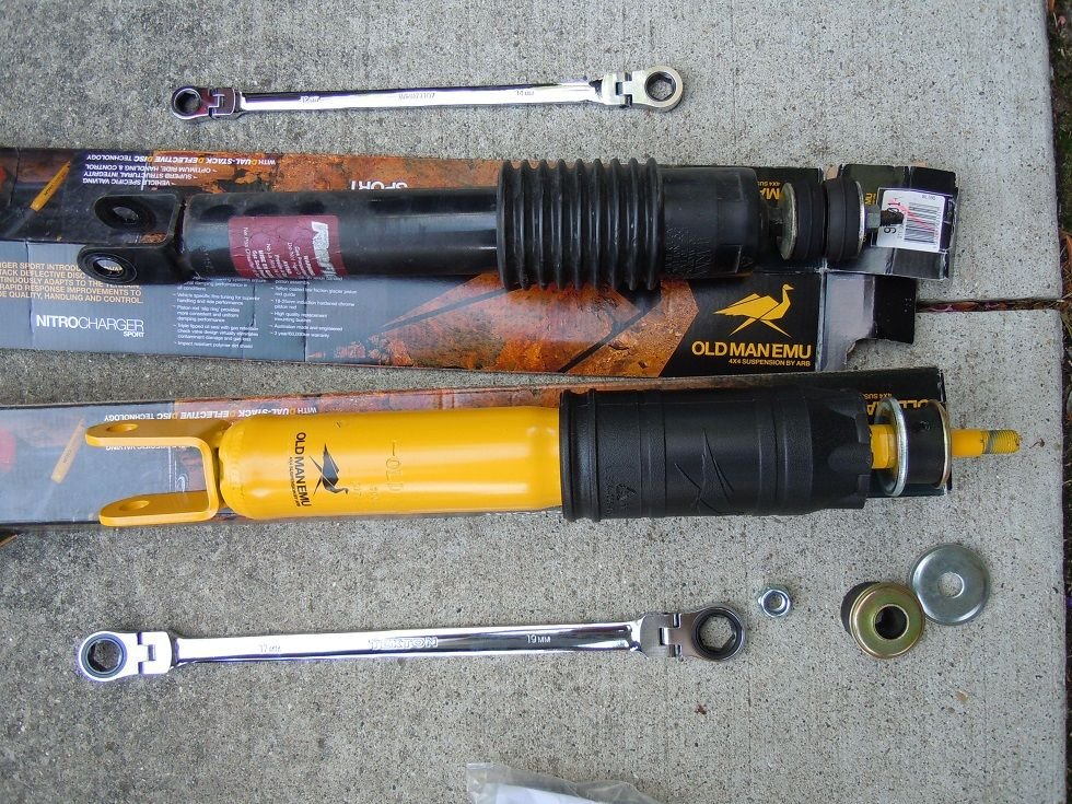

Hope you don't mind my adding a pic to your thread, but I put the OME NitroChargers on my H3 Alpha and they are the sweet. Just a side by side of the Monroe that the prior owner had put on the truck for the obvious no comparison.

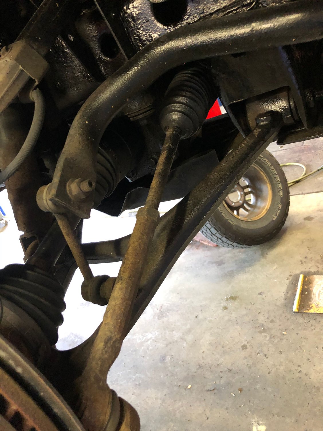

Not at all! I'm gracious to your responding. It definitely builds my confidence that I chose the right setup. Had everything installed. Took 2 days as when they removed to old leaf springs, the brackets and bushings were jacked and had to be replaced. Drove it yesterday..rides great on road and over train tracks, curbs (couldn't help myself) and really feels more solid than before. It's drives "higher" and definitely visually looks raised. Crawling under there is more room so I'd argue more ground clearance too. These 32's OEM look tiny. I will be measuring the height to really see how much lift OLD MAN EMU gives and to see where they adjusted the torsion keys today. I told them 23.5". Still need to decide on the tire brand. Going with 35/12.5/18s. And need to upgrade the inner/outer tie rods. Not sure I need the $400 Outfitter Design setup that Tainter reviewed, but I don't want to do $50 OEM either. There's got to be something in the middle or I may just each peanut butter sandwiches a few more weeks and just get them.
I added more pics of the install. The torsion BAR is much beefier than OEM.

The OEM (ACDelco) 16MM inner and outer tie rods can bend OffRoad.
That is why I switched to the OD Big Azz tie rods (I like rocks and had 37" tires).
