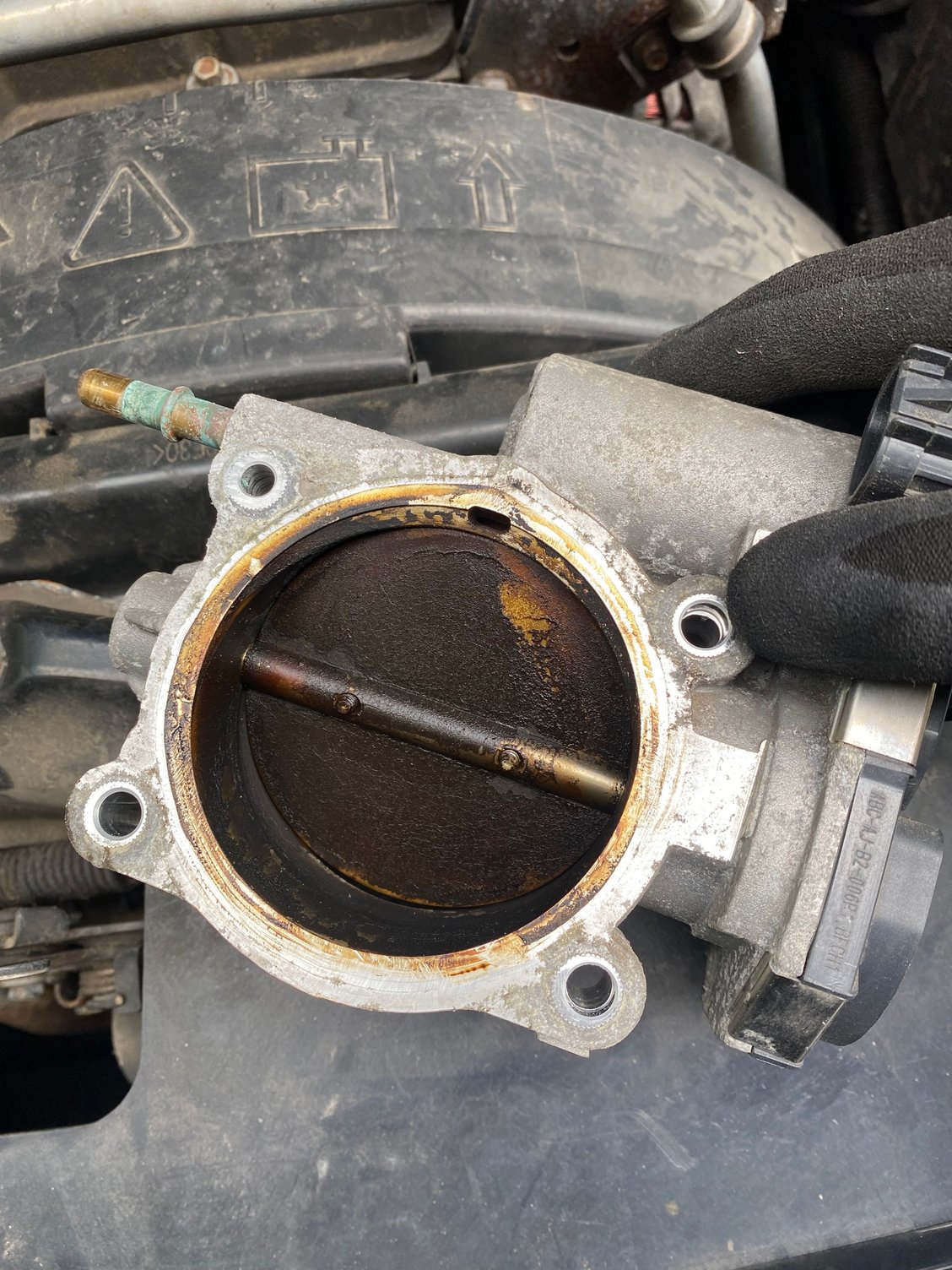

Mine was my passlock. The low idle is often a dirty throttle body and maf.

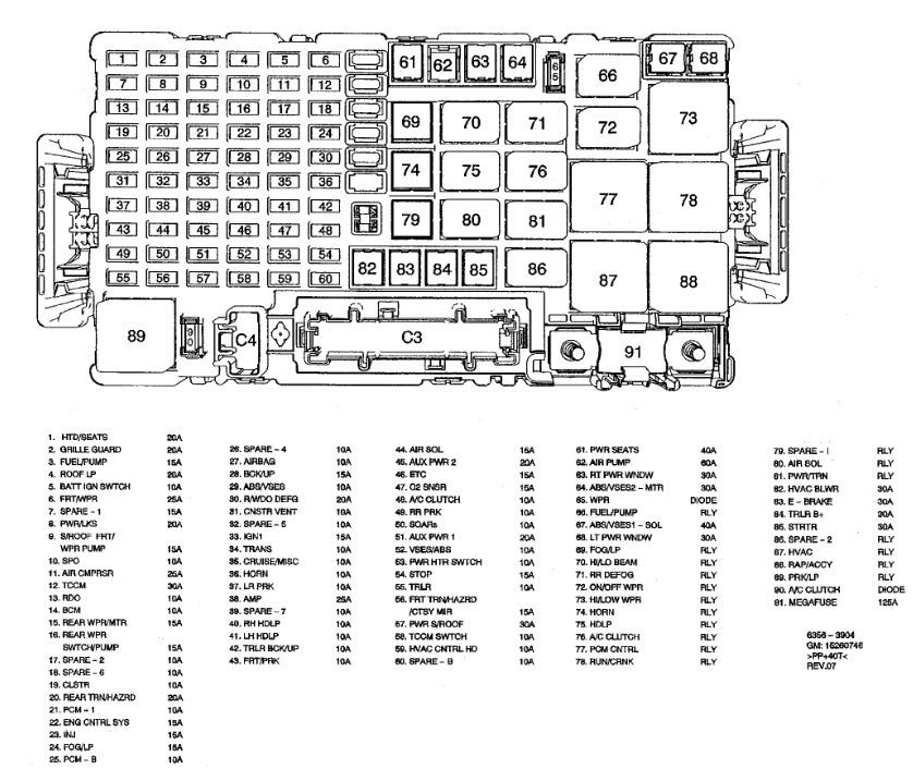

Old Sep 8, 2023 | 05:01 PM
Posts: 9,047
Swap relays #78 with #88 and recheck,

I cleaned the tb and gave it a spin. Felt alright—hard to tell in such a short drive. It was filthy though.
I didn’t clean the MAF. Seemed clean so I didn’t bother spray it. Should I still? I lost one of the screws though. Does anyone know the size so I can replace them both (old and Rusty).

Old Sep 9, 2023 | 04:17 PM
Posts: 9,047
Originally Posted by echopark
I’ll try get the ignition contact cleaned tomorrow after some research.
thanks for the story support!
Did you check #78 relay?
Old Sep 9, 2023 | 04:32 PM
echopark's Avatar
Joined: Dec 2021
Posts: 29
not so far. The electrical issue isn’t permanent so if I swap fuses I won’t be able to tell if anything changes because currently everything is working as it should (I think). Let me know what to look for when swapped
either way I’ll swap it shortly and report back.
