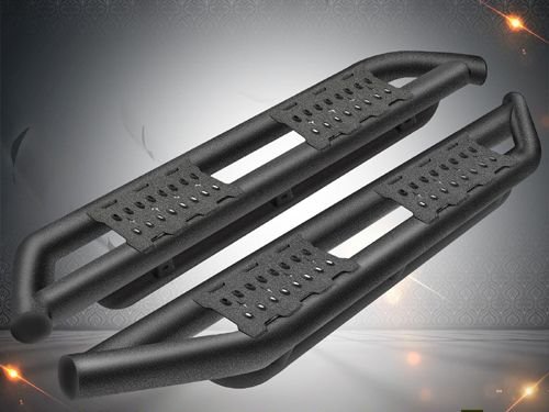

I'm metal fabricating hangers for a pair of aftermarket running boards and am looking for the mounting points underneath my truck. Any help with identifying these would be greatly appreciated.

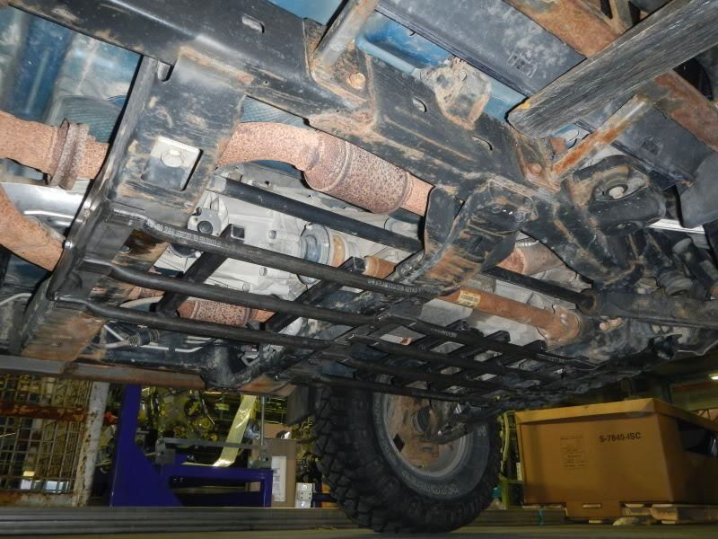

The same frame tapped holes for the Nurse Bars and Rock Rails. There are four pairs of two (one high, the other low) starting up front just behind the body mount. Below is an H3 for reference.
Old Jun 29, 2022 | 11:54 AM
Posts: 3,204
the rust really highlights the mounting positions

Thanks Doc, that helped a lot. With your photo as reference, I’ve located 3 pairs of mounting points on both sides of my T.
