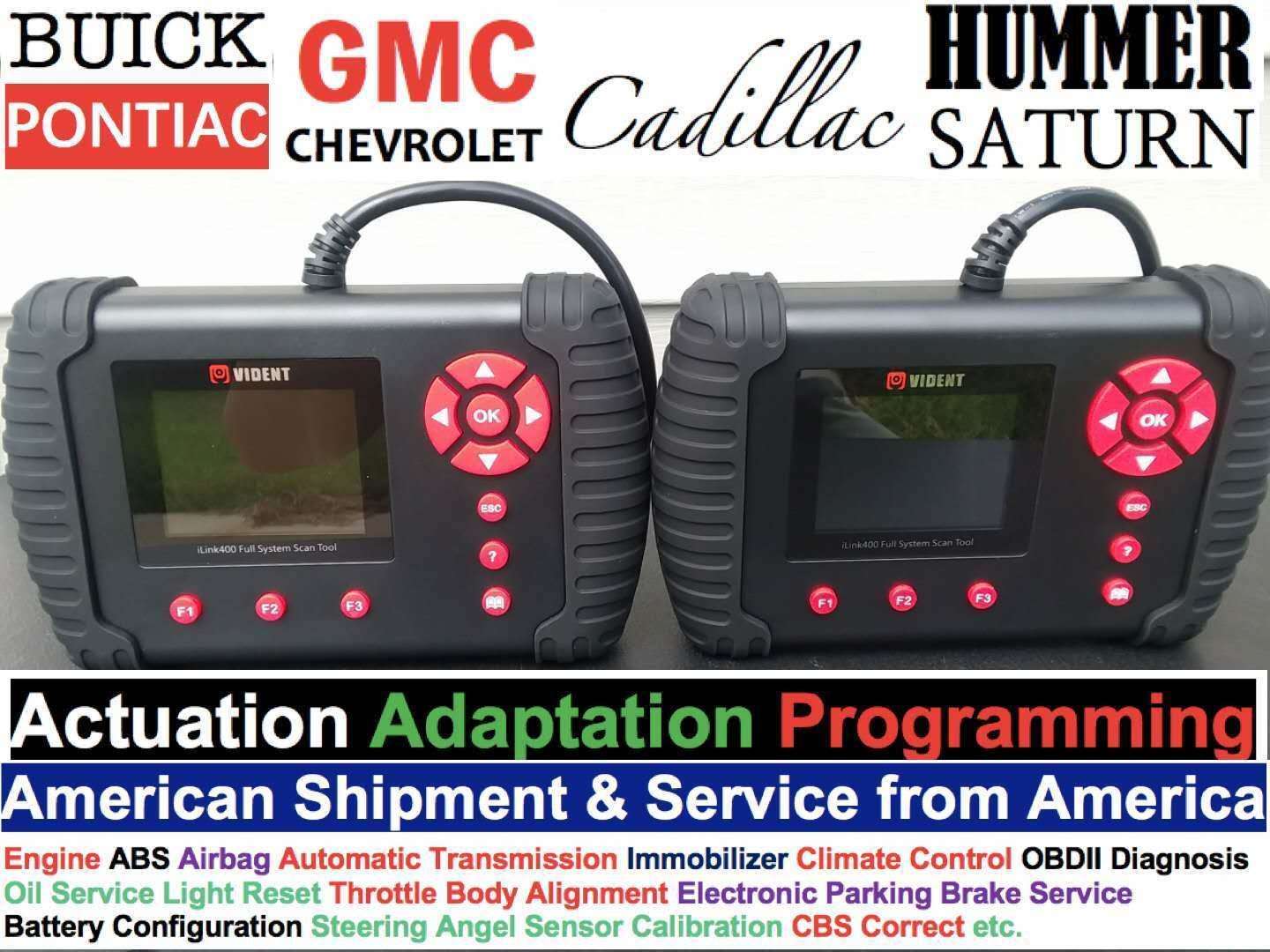

It takes a month to retrieve code(s)?
I can pull all P-B-C codes in a couple minutes:
Sure, courtesy of hummerz...........
STOP wasting money! Get a quality scanner:SCAN TOOL

What can I say? Winters a tough time to come up with an extra 150 clams to go buy a tool
