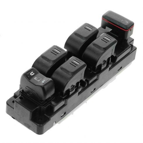

First off, sorry if this has been covered.
My issue:
ONLY the driver side master switch will roll down the windows. all other switches don't work and are plugged in and illuminated. What am I missing?

I know that switch, Thats not the issue unfortunatly

Clean/Replace the master switch.
Its a new Delco, still same issue

What part number?

what part number?
25779767

Check the connector wiring/contacts.

Power windows are on page 88. That and more can be found here: https://schwarttzy.com/h3-hummer/
That said, I had a similar problem. Not sure where you acquired your parts, but I went through three different switch assemblies before I found one that worked for me. I can only believe that the ones that didn't work were not for a hummer.
