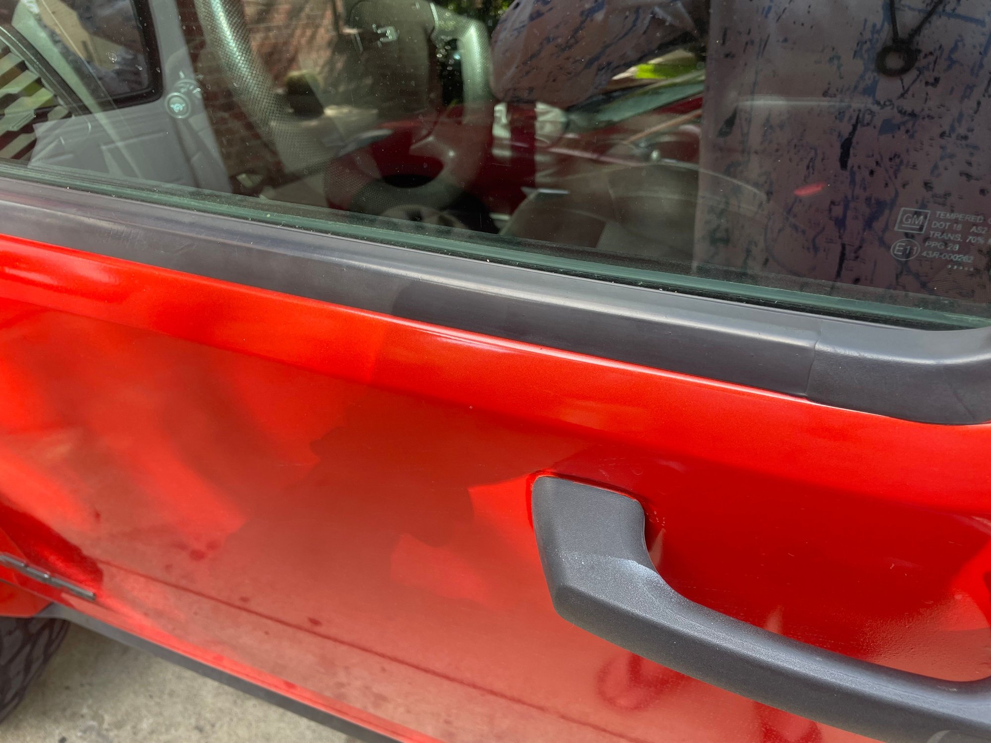

Has anyone had this issue? Water runs down into the door frame when it rains. Not seeing new parts out there

Window belt molding is not watertight hence the drain holes in the bottom of the doors.

Not sure what you mean but maybe I am describing the wrong part.
Old Yesterday | 05:36 PM
Posts: 9,024
Yes, that is the window belt molding>>>NOT WATERTIGHT<<<
IS THERE WATER POOLING IN YOUR DOORS?

Yes, took the inner door panel off and had a hose gently spray at the molding height, from inside watched water dripping down from middle to front of the window.

Clear the drain holes in the bottom of the door so the water runs back out!

That’s crazy, I’ve never seen this in my life! Never had a vehicle get water in the door. Thanks for the help

All vehicles allow water to pass through the door without you knowing.
