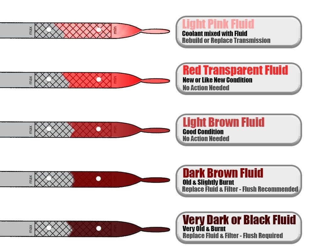

Have you recently changed the transmission fluid? Check transmission level running at operating temp. Also check condition of the fluid.

Thanks everyone. I checked the trans fluid and it needs changing (had the pan dropped and changed about 60,000 miles ago) but it's not low at operating temp or cold, the cooler seems to be in between light brown and dark brown and doesn't smell burnt.
