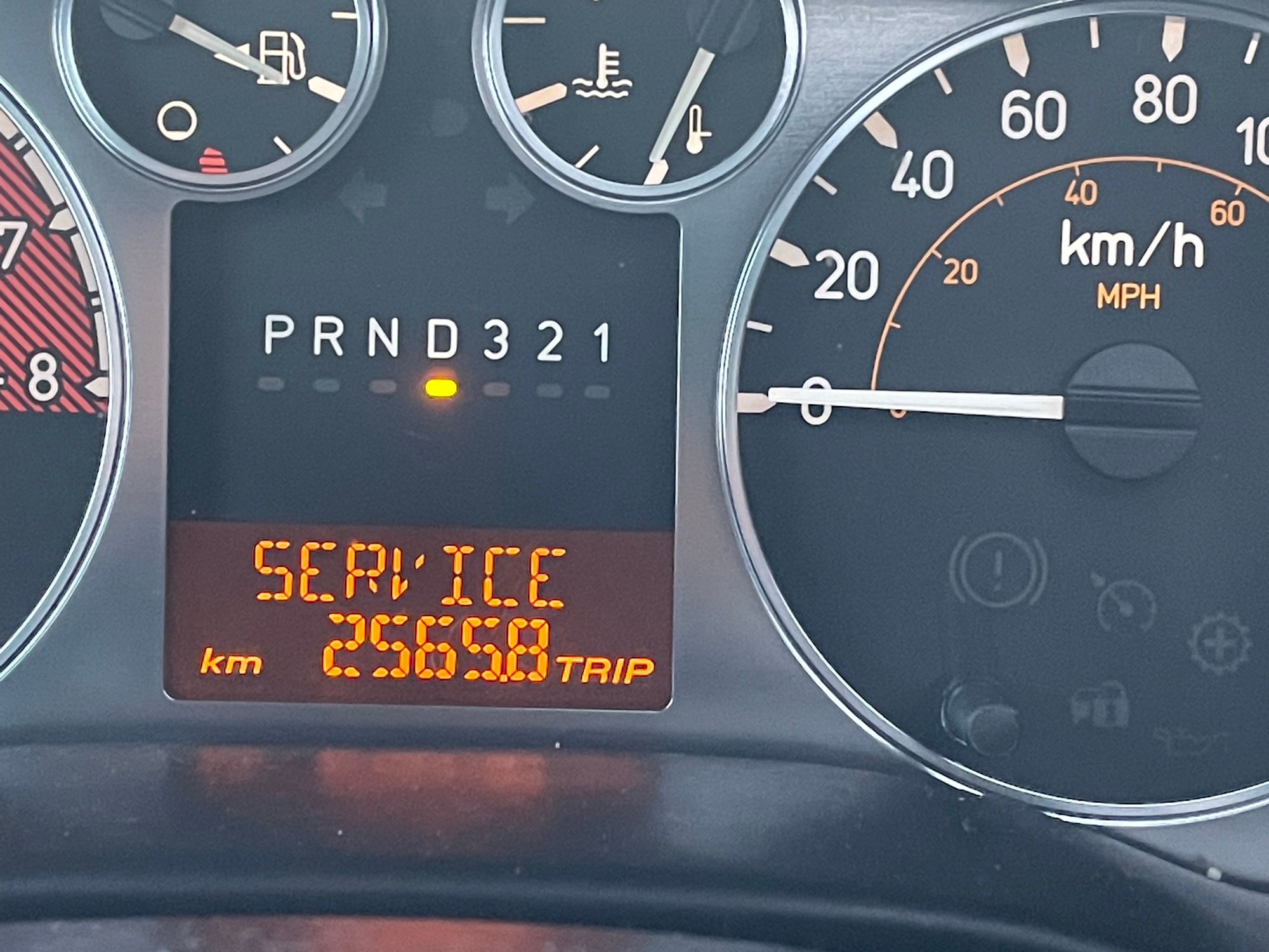

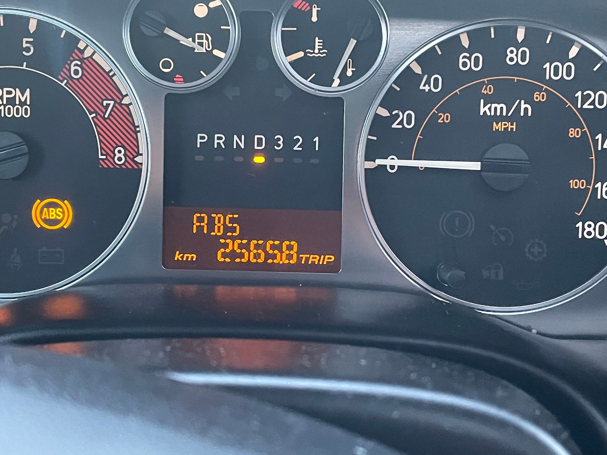

I seem to get a lot of warning lights on my 2008 alpha. Sometimes they only last a few days and go away.sometimes it’s a light and sometimes it’s words on the screen. I can’t figure out if they are real warning or not because they are intermittent. This happens so often I’m now ignoring the
warning lights which is not a great solution. Anyone face this problem? This is my current dash and the one from last week.

Yep. You may want to do a little testing and pull some codes. Or take it to the shop to have them.

You'll need the codes to dig deeper. The codes will be stored even if they aren't currently showing. It could be so many different things that there is not a bit of advice you could get that would be worth anything without them.
I had an intermittent traction control warning recently that turned out to be the steering wheel angle sensor - needed to clean the contacts. It too would go away.
Get the codes. Many people here can help after that.

Thanks. I’ve purchased a code reader. Also this morning I have no warning signs. Stoped at a store for 20 min turns the car on now I have a bunch again.

Plan on cleaning the contacts/connectors for all wheel hub sensors and inspecting the wiring for compromise. Same with the Transfer Case shift actuator.
Can't really help further until we know the codes.

Old Jan 4, 2022 | 03:16 AM
scoreh3's Avatar
Joined: Aug 2012
Posts: 102
Do you still have the factory crappy battery terminals? They gave me all kinds of electrical issues. If you have that many codes all at once try changing the battery terminals.
Old Jan 4, 2022 | 05:36 AM
Rogcapital's Avatar
Joined: Oct 2021
Posts: 33
Yes they are still original. I’ll replace them thanks.
