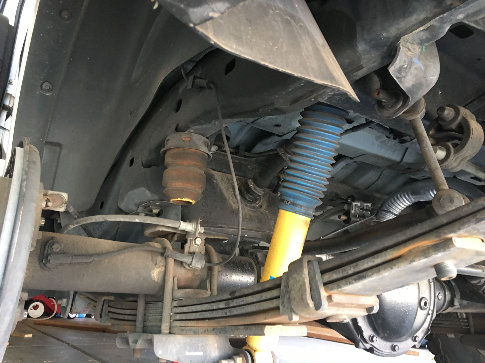

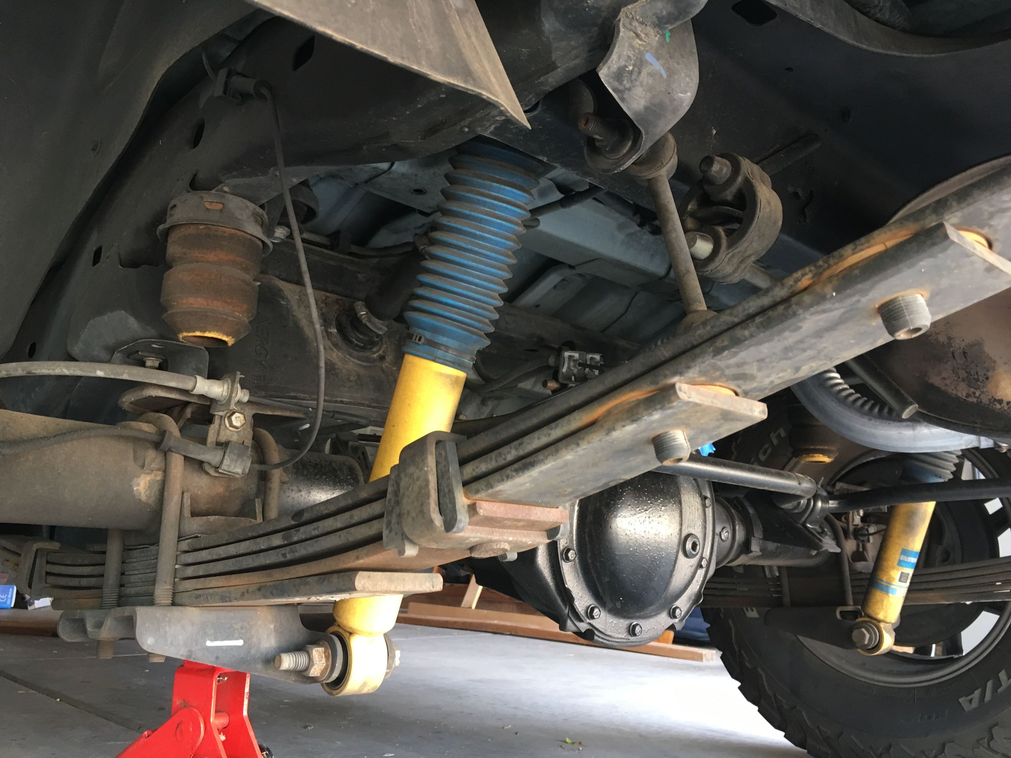

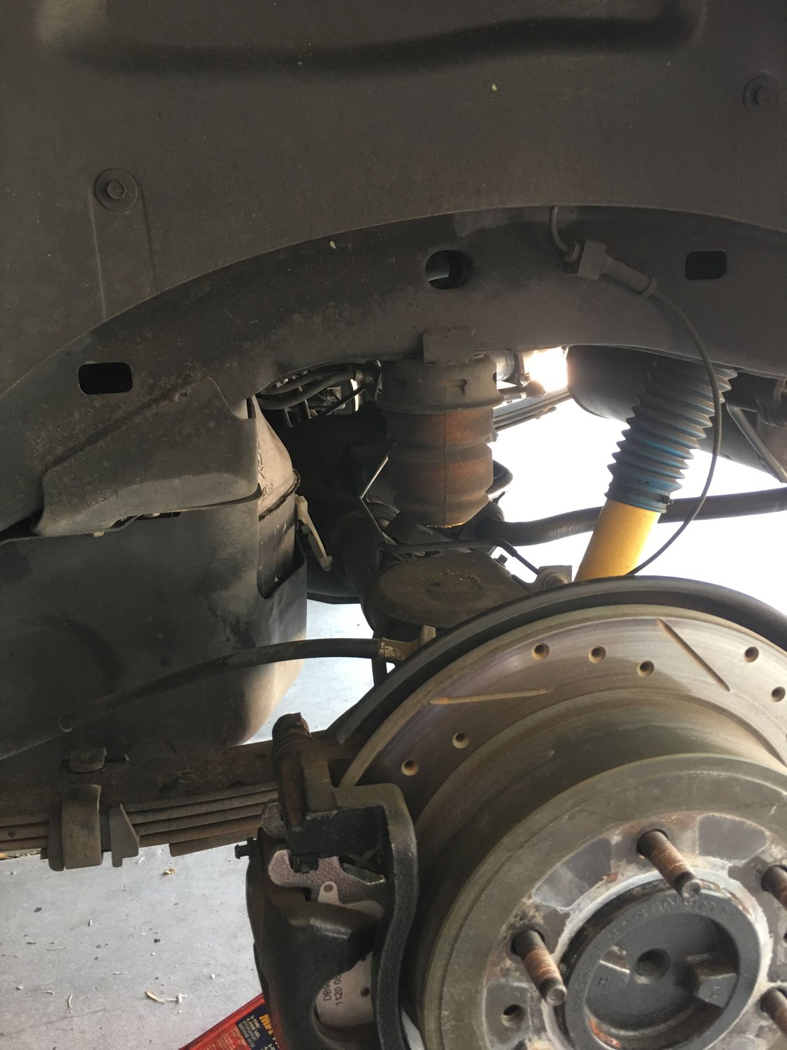

New owner have a few questions about shocks etc. front seems fine rear rides like the shocks are steel poles with no cushion whatsoever. Took a few pics during a brake job yesterday just wanted some input. These can’t be original shocks correct? Doesn’t look like anyone lifted this or anything
thanks in advance
Old Aug 14, 2018 | 09:43 AM
Correct, GM does not make Bilstein shocks, and they were not an option. An owner before you put those on.
