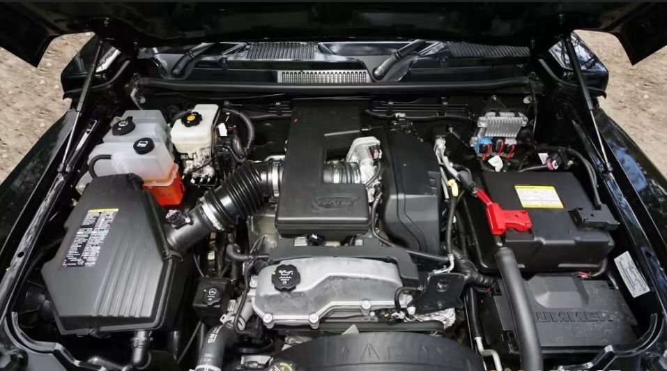

The CAI OE?:

The CAI OE?:
I truly don't think it's the air intake, further research suggests it's definitely servo squeal from the throttle body. My question still stands, is it worth getting a new ECM or is this something that can be "retrained" out?
