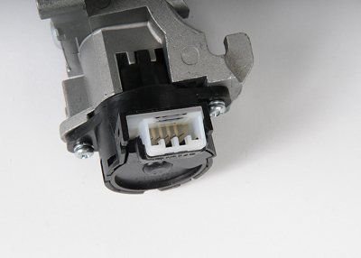

Could be, but how could you f'k up the ignition switch when you removed the fuse block? Ignition Switch harness is open or shorted. Ignition Switch circuit poor electrical connection. Check voltage at fuse #33.

Yes, if you broke a pin. Inspect and make sure they are all there. '09-'10 3.7l 25783694
