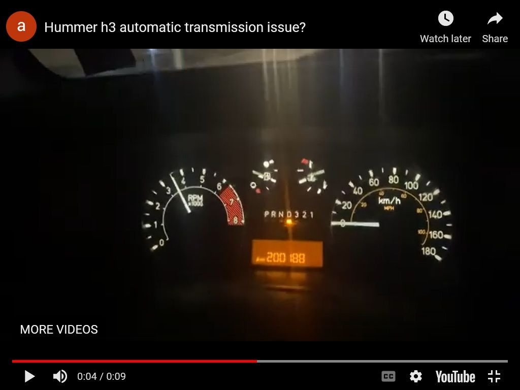

quick update the transmission feeling it's more like its on low 4*4 high.
I will try to upload a video in YouTube if it's incounter me before changing the oil.

The transmission fluid color looks ok not brown and not red.
the problem happened again i uploaded the video for your information

Old Sep 16, 2022 | 06:44 PM
https://youtu.be/Qfp_BxUMQ6g
WTF? DEAD SPEEDO!

Any idea about dead speedo problem??

I’m having same issues. I’ve done all then obvious elementary things stayed like checking and sniffing the trans fluid and also had the trans rebuilt by a reputable shop. The problem came back. He changed the TCM(transmission control module) and it helped for a while but has returned again. It was a salvage part as a new one would have to be programmed by dealer.
When removing the old one after driving a while to make it fail, the old one was very hot. Honestly I’ve done all the simple and expensive stuff too and to no avail. Had something similar happen to my Chevy pickup and changing the switch module on the dash fixed it. I’m going to give that a try but had to order it. Actuator motors and fluid changes haven’t fixed this issue and mine is doing exactly the same as in that video only not moving until you turn it off and start it back. Something is resetting to cause it to work again. Had to be electrical in my opinion but who knows. Love this 2008 H3 but frustrating.
