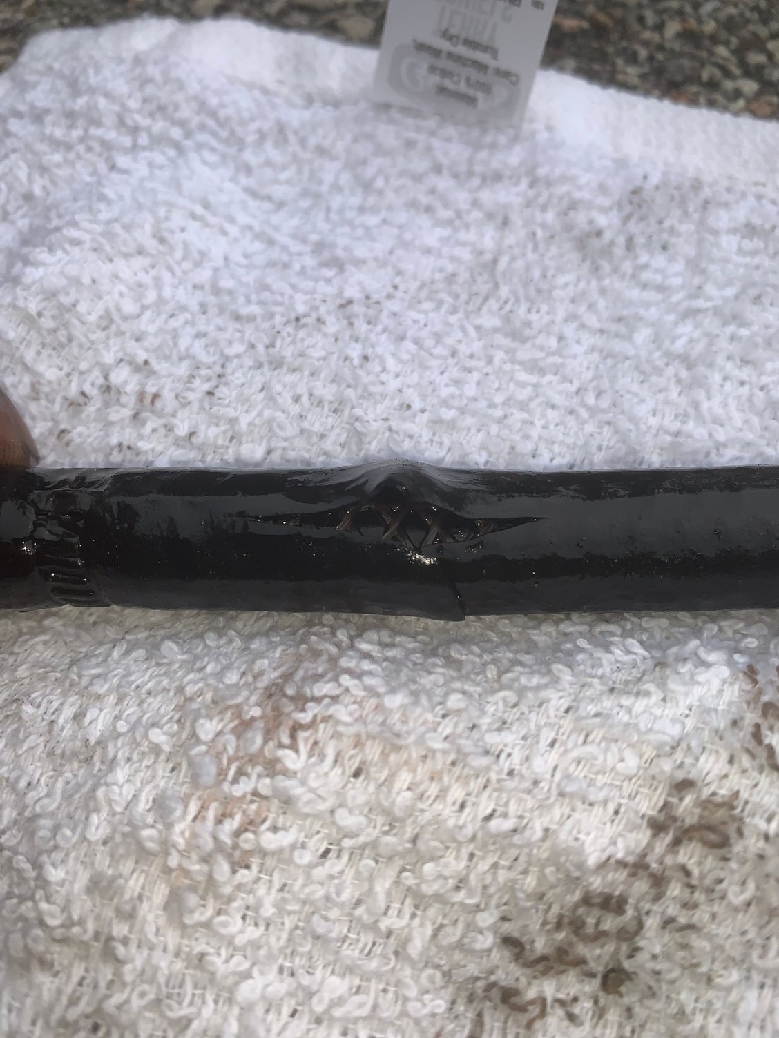

I have maybe it’s just a few millimeters pass the flare I tried to use a high pressure hose came on the few mm but no grip on it.
I’ll use the worm clamps right on top of the bulge of the hose on the flare for added piece of mind.
for those of you interested, this is what happened to the old hose:
Old Jun 5, 2021 | 05:30 PM
Posts: 9,047
Did you notice the braid? Enough to hold air in a football.

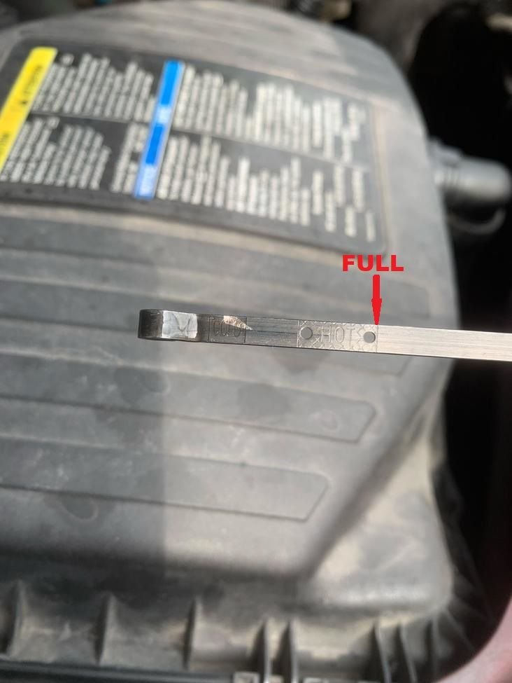

Originally Posted by asutrave
I just checked, drove around for a few minutes, checked dip stick and it's still sitting at "low", if not a little bit higher than "low". Shifting was all out of wack, power delivery was poor, and sometimes RPM's ran super high before gear change.
"Low"? You need new glasses? Post a picture where it shows "low".
My indicator is marked "COLD" & "HOT"! Check @ Operating temperature, also has 2 holes (for the visually impaired) that show the full level (top hole=full). ADD MORE DEXVI, (a little at a time) UNTIL YOU GET THERE.

Sorry, was typing from memory lol Here is a picture of what it looked like:
I will continue to add some more Fluid! Thanks for your positivity, I am praying things are all okay.
Old Jun 6, 2021 | 05:57 PM
Posts: 9,047
Great, that's an OEM indicator. Again, running @ operating temperature. Pull, wipe, insert, pull again , then check level.
If you need to add, wait for it to settle. You want to be here:
