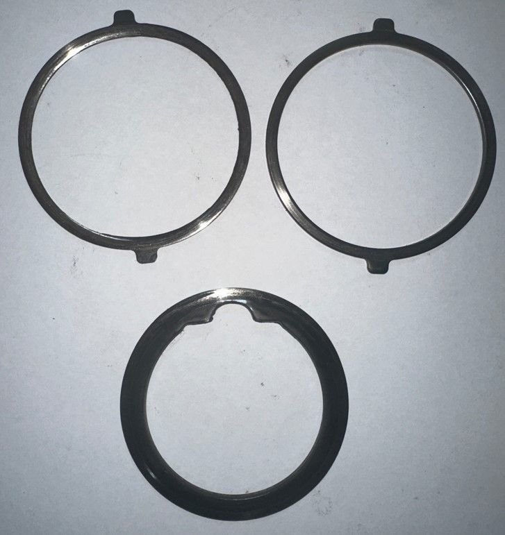

Does anybody know where I can get a Thrust Washer for the BW4494? I can't find any listings for this part....
I'm in Australia where Hummer H3 parts are hard to get.
It might be the same as the BW4493
You will notice that the washer is no longer flat, but curved much like a Belleville spring. This happens because helical cut gears want to "walk" away from the thrust load of the gears bending the washer.
I have this problem: TRANSFER CASE CLUNK IN 4LO LOCK
I figured out the problem from this guide: https://atracom.blob.core.windows.ne...09/taming.html
This thrust washer is apart of the input gear which is inside the planetary gear.
